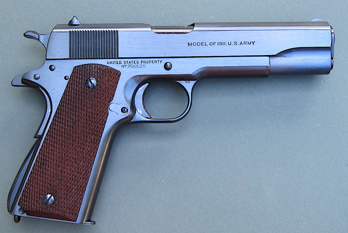

                Basically, the year of the accpetance is 1927, for the 1911A1.
                The frame charateristics are: the scallops on both sides of frame where the trigger emerges from frame.
                The "arched" mainspring housing, formong the back strap.
                and the front and rear sights were increased insize and height, for better low light conditions.
                The 1911 charateristic are:
                No scallops at trigger.
                flat [straight line] mainspring housing.
                and small sights.
                A slide is condered a replacebale commodity, only the frame is Serialized for record keeping.
                  In 1924 the military received 10,000 new 1911 pistols from Colt beginning with serial number 700001. The pistol had several improvements including a new short trigger, finger clearance cuts in the receiver behind the trigger, an arched mainspring housing, a longer tang on the grip safety, and a few other minor changes. It was to the the Model 1911 Improved, but in 1926 Ordnance decided that it would be the Model 1911A1. It was decided that from then on any 1911 style pistol below serial number 700,000 would be a Model 1911, and any pistol above serial number 700,000 would be a Model 1911A1.
                  Ordnance did not order another Model 1911A1 pistol until 1937, and forgot to have Colt remove the MODEL OF 1911 U.S.ARMY marking from the slide, so all of 1937 production still had the 1911 marking.
                  A Colt 1911A1 "Transition" shipped February 18, 1924 to Springfield Armory.
