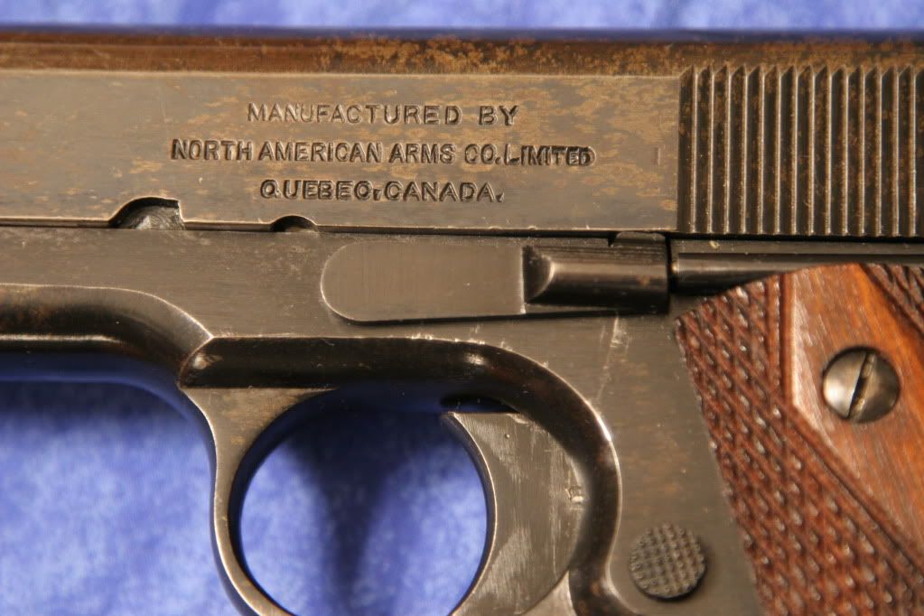

              Wish we could learn more about this pistol (#19)... if correct, it is in a very small club. I know of 24 North American pistols but I don't know how many of these 24 are correct. (Most of these S/N's came from a published list in Meadows.)
                There wasn't a "Black Army" finish. Colt used the same oven bluing method as the previous gas oven blued guns, but the surface preparation and bluing operation was speeded up resulting in a less durable finish. Remington-UMC suffered from the same fragile finish.
                What is the black copper oxide finish as used by NAA? This would appear to be a hot caustic blue.

                  I compared the pistol to 77 at m1911info.com and in my amateur opinion, it's been refinished and the slide markings are not as deeply struck, possibly due to refinishing. I did not see a 19 on the trigger. The dealer said he bought it from a collector that also owns #89.

                    While the 19 looks like it was stamped, the slide legend has the appearance of being pantographed.

                      i would have to agree with you, while the picture isn't very clear, it looks like the characteristics of the legend are incorrect...

                        Slide marking "LIMITED" definitely engraved, not rolled on or struck. Can't really see the pistol well enough to say what it is, but it certainly isn't an original NAA slide marking.

                          Yup... faker. So much for half price.....

                            Agreed... Not even close.

                              Here is what the legend should look like. (This also shows what the original finish looks like.)
