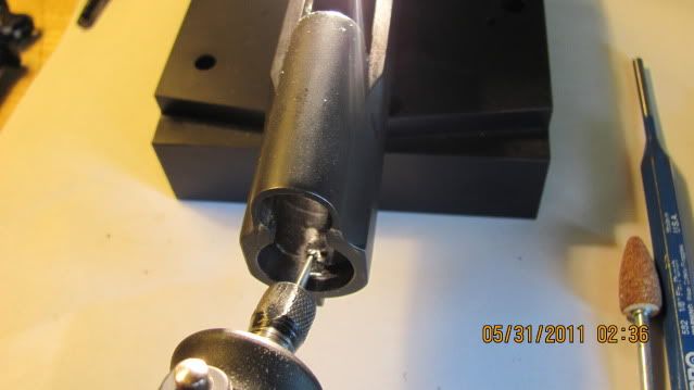

    Use a Dremel ands a 1/8th" Ballcutter to remove the old tenon in the slide dish as shown.

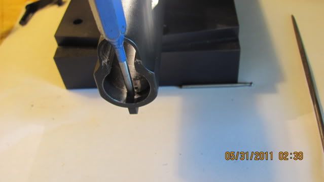

    Next, use a 1/16th,longnose punch to punch the old sight out.
    Clean up and square the tenon hole,insert the new sight, make sure it is running straight, trim off all the tenon that sticks out above the slide dishout, rest the slide upside down on a steel surface to support the blade and Whack the tenon with a 1/8th." longnose punch. I showed the punch and sight hanging over for clarity on where you strike.
    After the initial strike,move the punchnose around and strike the tenon, spreading it out. Then file off anything sticking out that could interfere with the bushing and you are done.

        Dave, Thanks. This is what I was thinking of doing originally but wanted someone else to verify it was a valid idea before I tried it. New sights are on the way. We will see what happens.

              Found one cone shaped stone bit which worked really well. Stayed up way past my bedtime but I got the sights replaced and coated the dots in Duraglo and flourescent yellow front dot. Can't wait to go to the range and see how much worse I shoot with upgraded sights....LOL
              Thanks for the advice and photos. I peened it and then epoxied it too. It might stay in place.
