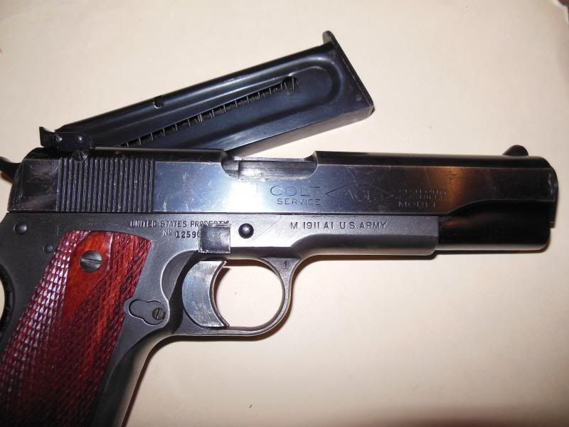

      Will try to get some pictures up a little later. Markings are on the right side, my booboo. The finnish on the ace upper is blue Ithaca frame is original park, phosphate.

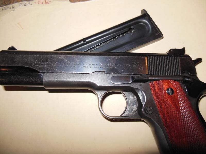

        [/IMG]
        I hope this helps. I can post more pictures if this works.
        thanks Smoky

          [/IMG]

                You have an early upper in the original finish from a Service Model Ace. The slide markings and the rear sight are slightly different from the later SMA's.

                    Not bad, as the upper functions just as well as a conversion unit, and most conversion units are priced in the $400/500 range, so that doesn't leave you with much in the Ithaca lower. The trigger in the Ithaca lower is a 1911, and the slide stop appears to be blue.
