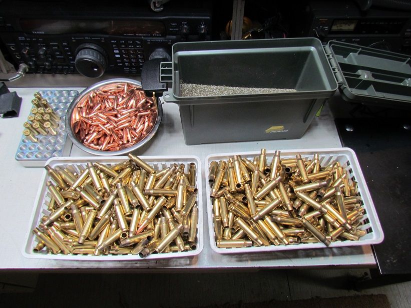

    After a little thought, very little, there are 800+ rnds on the way to the collet puller. Soon to become re-loading components minus the brass and primers.
    Just pulled down 100 rnds and the reason for inaccuracy is quite evident. Not sure what the power is but load varied almost 4 gr, from 37.9 to 41.8 with the majority around 41.4.

        Had a gentleman that live close by the producer and he claims that they were using Varget. Load weight would indicate the possibility. I plan on re-using the bullets and powder in good brass and load per Varget seeing that's my favorite powder anyway.

                          Worked on breaking down 600 rnds of this junk today. Great way to spend a couple of hours.
                          Separated out a few of the different head stamps.
