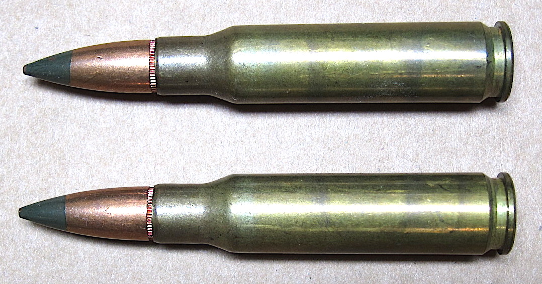

            What are these? 7.62X51 with FA 57 and Nato mark, with olive drab tip. Pulled one and projectile is 173 grain BT. As can be seen, has been belted.

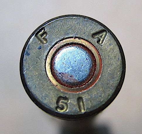

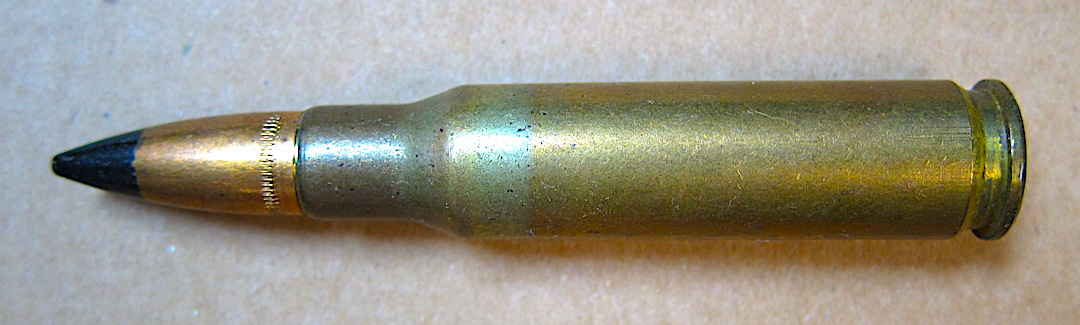

                How's this for early. Black tip, FA 51, no NATO mark.
                • RCS
                  • 2180
                  the start of the 7,62mm
                  JP - never seen a AP cartridge that early.
