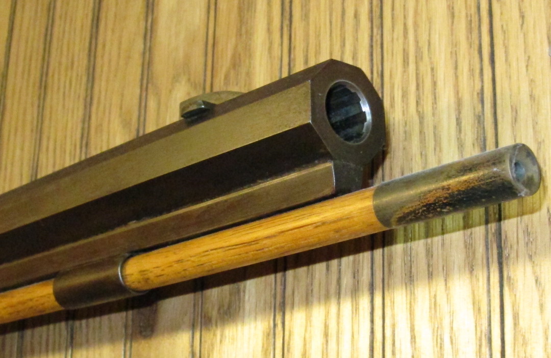

              On this one from hickory I attached a tip that is threaded to take various tools, and made it slightly longer than the bore.
