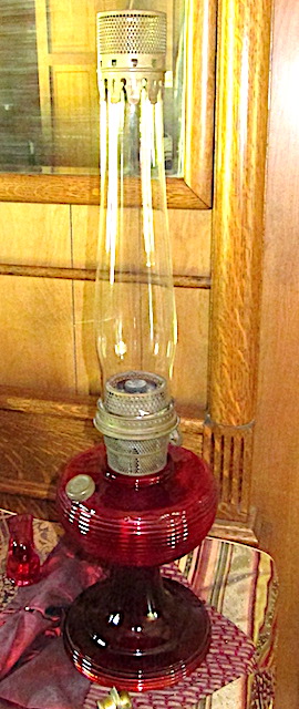

            To S. A. Boggs,
            Glad someone else appreciates the Aladdin lamps. Had about 30 at one time, but thinned them down. This was always my favorite, a ruby red beehive with all original parts. Chimney is Pyrex.
