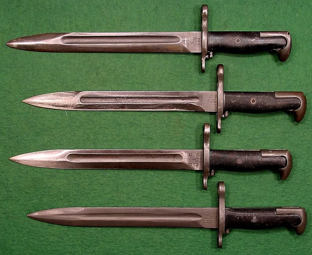

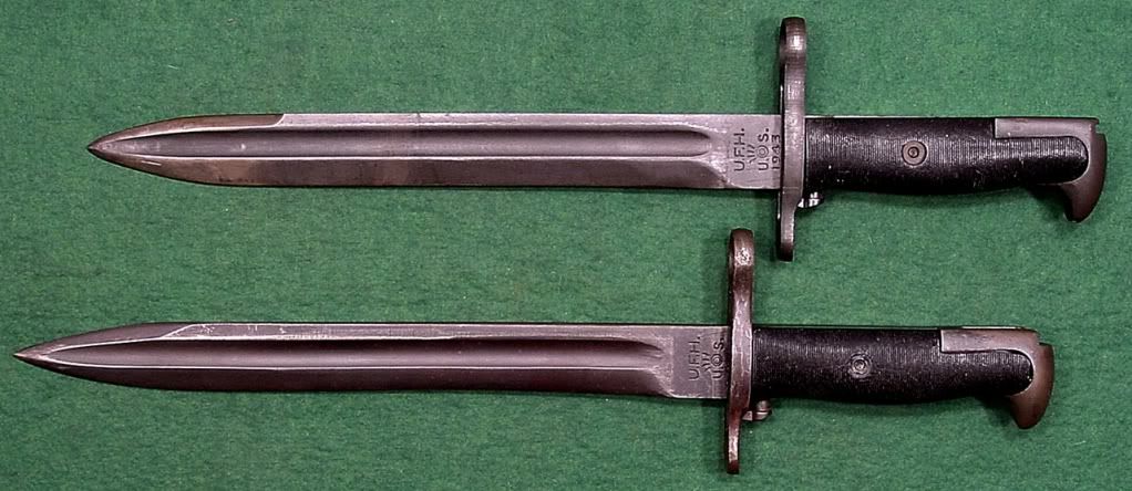

            The photo below shows the 1943 dated M1 bayonets (as far as I can determine, AFH did not make a dated M1). The bottom one is the UFH and you can see how the fuller just sort of "fades" away rather than runs out at an equal depth as it would if it were a true cut down. The second photo shows two shortened M1905s by UFH so you can see the obvious difference. Notice that the lower one in the second photo is shortened but undated - UFH is the only company that I have found (besides AFH) that made 16 inch blade M1905 bayonets that were not dated.

                        Bayonetman, I have a 1943 dated AFH that looks like the UHF on the bottom of your first picture. I assume it is a cutdown.
