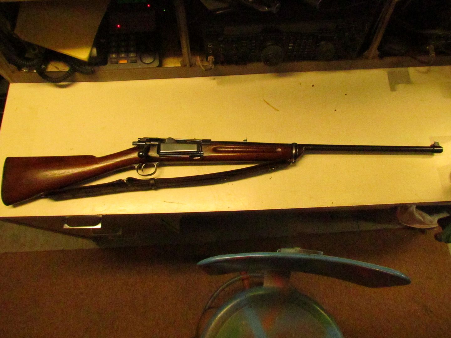

    Howdy Gents,
    I just acquired a sporterized Krag rifle with 23 1/2 " barrel in the 405,XXX ser number range. Just wondering if a bobtailed bolt and buckhorn sight might have been a trademark of someone known on the forum. Excellent bluing job and all parts look new. Just curious. Oh yea, this rifle was supposed to have been left in a closet since the early 30s.

    Could you post some pictures? They might help some of us get a better understanding of what you're talking about.

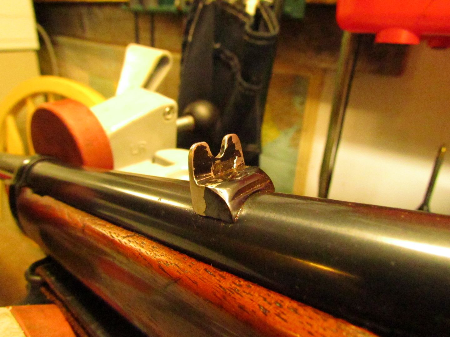

            Thanks Dick, I will get some photos soon. I thought that and the fixed , I think aluminum, buck horn rear sight. Forward rear sight screw hole looks to be filled with a screw that was finished flush with barrel and then the whole shebang was very nicely blued. Springs on the feed door close the thing like a bear trap. You don't want to get your fingers in the way. My other Krags open and close very gently compared to this one.

              May take me a few minutes, but here are a few photos of the rifle I was asking questions about.

                Not un-atractive, though I'd have done a few things differently, like leaving more wood ahead of the band, and that rear sight is pretty much set for one load, at one (fairly short) distance.
                Interesting about the mag box spring tension - have you checked to see that it is assembled the same way as your others?

                  Thanks Dick. It may be that my others have been well used over the years. Nothing seems worn on this except the paint has partially come off the sight. I agree with the one load one range on the sights. Strictly for hunting at relatively short range. The bob tailed bolt and the sight is what caught my eye. I have cleaned a ton of crud off the rifle and out of the barrel. Bore is now nice and shiny and guages just under a 1 at the muzzel.

                    Not done by a well known commercial shop, like Sidgley or Stoegers. They always restocked with a sporter stocks.

                      NF1,
                      That's a good-looking sporter. I like the treatment on the stock fore-end. You could lose the rear sight and have a Marbles/Lyman adjustable folding leaf sight, or even a set of express sights, and get some versatility and probably a better sight picture.

                          I'm guessing the barrel length measures 24 inches muzzle to bolt face. Not a bad looking sporter, but I agree about that rear sight. I would look into replacing that!

                            Nice looking rifle you have there, but as everyone said the rear sight would have to go if you want to get the full benefit out of the 30-40.
