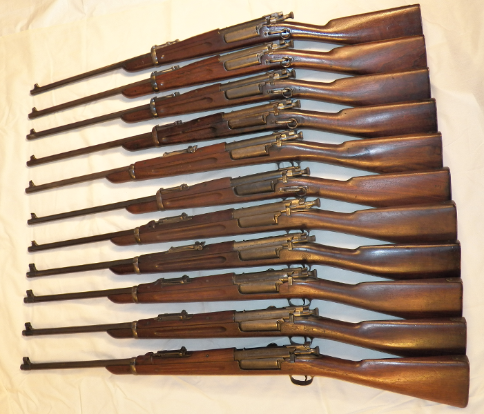

        The picture:
        First block: 95, 96, M96
        Second block: M96, M96 in long nose stock with 1902 sight.
        M98, M98 in 99 stock,
        M99 first block, M99 second block, M99 third block sans humped guard, M99 third block with hump.
        One could add the 96c/long stock with 1896 and 1901 sight, 98C with 1902 sight, and 99c with 1902 so there is room for growth. I could back up that last without effort and likely will for the book as it clarifies the picture me thinks.
        The 1898c with long stock and 96c sight is likely invalid. I gave that some thought and the more I though about it the more true it became but I forget why.
        Let's not forget the 99 in PC format with JFC cartouche. Have one.

                The exterior lightening cuts on the 1896 and 1898 carbines are shorter as the barrel band sits closer to the receiver. This is why I'll have to have an M-1892 carbine stock special made. The lightening cuts on that were "carbine length" so cutting down a rifle stock won't work. An early M-1896 carbine stock with the nose snipped off and a new forearm grafted on would work as the early 1896 stock has the right comb. As we all know early M-1896 carbines stocks are floating around in truly generous numbers.
                That's a carbine stock. The lightening cuts are key. Review the distance from the barrel bands to the lightening cuts in the attached picture and then review OP's stock. Carbine.

                75010 is dead center in the second block of M-1896 carbines. The receiver is a carbine.
                Lightening cuts. Defines the early stocks as carbines.
