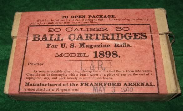

              This box is dated 1910 probably still a pretty common item then I imagine more then a few Krags were still issued then.
                  Note that the cartridges were re-packed in 1910. They could be of much earlier manufacture.
                  Ray
