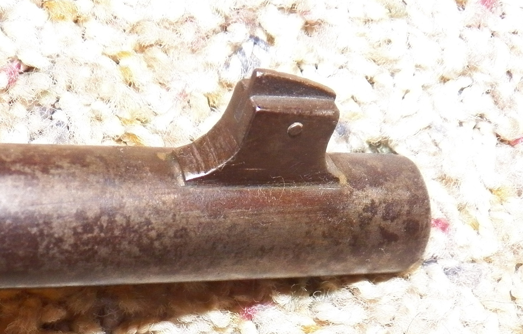

    Interested in opinions.
    Don't out-think yourself. Just tell me what you think. Trust me you won't hurt my feelings...
  • 1mark
    • 390

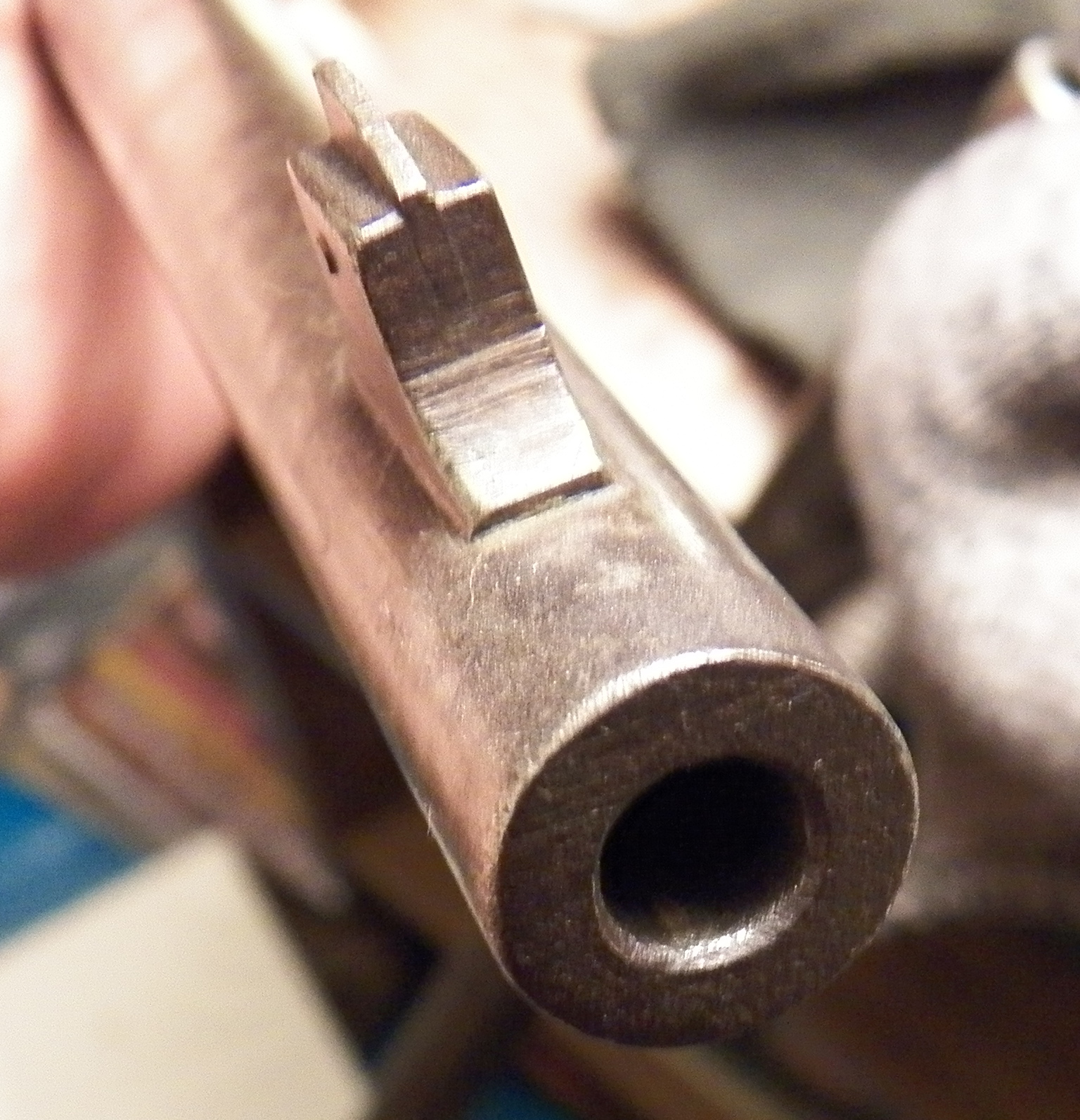

    The barrel looks to have been cut with a hacksaw and the crown is poor to say the least.

      I do not see evidence of the dove tailing that is done on standard issue Krag front sight posts .
      • psteinmayer
        • Sep 2011
        • 1527

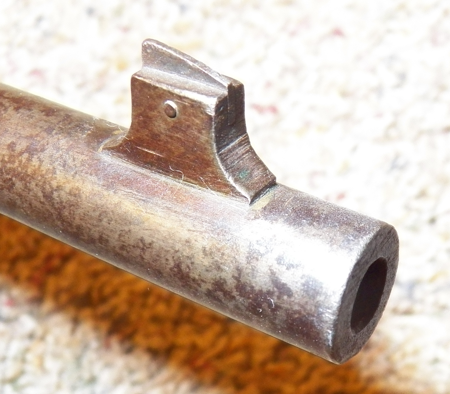

        Looks to me like silver solder on that base... and I agree that the barrel looks like a hacksaw job.
        • Dick Hosmer
          • 5997
          Lots of file marks on the sight base, too. One thing, it certainly doesn't appear to have been done recently, which begs the question of why the crudity if it is from "period of service". Field repair?

            Exactly. It wasn't done recently but it's obviously done crudely. Looks brazed to me but I'm not a metal worker.
            1930s maybe? The gun was used after that. The finish is gone and the entire thing has use wear. Doesn't show up clearly there but it's sporting dings on the end. Use dings. Dented end dings.
            Why did they spend the effort? After cutting it an inch too long? Some people mystify me. Why not just install an '03 base? "Faked!" Nobody would pay for a fake Krag at that point in time. If it was more modern I could see that but there would be no value back then. Kind of like faking a Yugo right? What's the point? I've seen people have restored 1970s four door cars. I raise an eyebrow on that. "Ok, so you took a Pontiac Lemans, which was never anything to write home about, and spent a considerable about of time restoring it to a car that isn't anything to write home about. Why?" I'd have to assume they had an uncle. Who did this.
            They wanted a carbine barrel. They made one. Maybe because at 30" it looked dorky. If it was 22" I'd say they cared more. It's 23" so they didn't. I fail to understand why they bothered.
            When a gun comes up at auction sometimes it's good to see what's there instead of what's not. That one came up. "Um, that's a bad attempt at an M-1896 carbine. Totally bogus. Moving on."
            I didn't. I bought it. Why? I wanted the receiver. 24110. One of the two I have which will be mock cadets. The extra parts that came with it were pretty much free given what it cost me. As an added bonus I get an early M-1896 bolt with the fixings.

                Which is why that one bugs me. It's a crudely done carbine length barrel. Except it's a bit long. Not "measure once cut once" but "somewhere about here." Didn't even bother measuring. Just "about here." Then took the time to do that sight work which, while not up to armory level, isn't quite the hack job people think. Crude, yes, but it'd be easier to just affix an aftermarket sight. So why bother?
