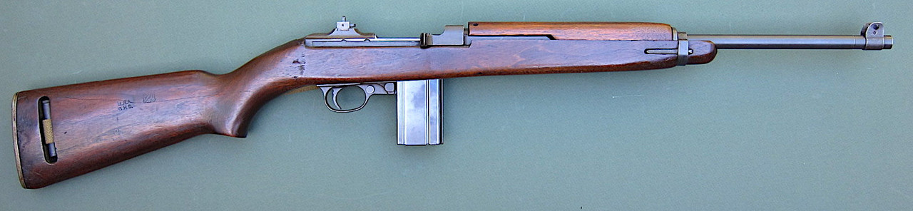

    I thought I would check with you guys that know more than I do. I have a very nice , never touched Win. # 57798xx with ajust. rear sight and type 2 unmarked barrel band. Not even the stock has been touched.
    I just today picked up an other Win. that is the same. I had it all apart and it's all Win. and matching wear. Even the stock has not been touched. The ser.# on this one is 57887xx (BUT) it has a typ. 3 barrel band. My book say's it's a little to early for the typ. 3 band. The band is stamped C. What do you guys think,? been changed or was on from new.
    Thanks for any help.
    Smoky
    Things to look for would be wear marks for both barrel band types on the front stock and signs of mounting/dismounting front sight to facilitate a band swap.
    Truth is Carbines have been heavily worked over so there is no way to truly know.
      It could be correct. The serial number range of your Carbines covers production from February to November of 1944, and the bayonet lug was added to the Winchester in late 1944. The first bands with bayonet lugs were stamped with a C on the left side.

        This band does have the C on the left side just below the swivel. I would love to think it is right for the gun. It's a nice Winchester but not T marked like my other one. I payed more for this than any carbine in my life. What is going on with the price of this stuff.? I guess $20. DCM guns and $100. to $150. at a store days are gone.

            That is is great Winchester that you have. Hear are some pictures, Not very good. The cross cannon on the stock is very nice and clear but not to good in the picture. So there is a chance the typ 3 band my have come with it.? I have never seen wood like this, what kind is it. ? Also, where can I get Carbine birth from ser. numbers. ? Thanks for your help.DSCN1372.jpgDSCN1372.jpgspencersjoy@gmail.comDSCN1377.jpgDSCN1376.jpgDSCN1375.jpg

                      You guys are all great . I know this is the place for good information. I have pulled the Win. apart and it is all Win. by the book. I like it and think it's a keeper. I also picked a IBM last week that has not been through the rebuild program. 3877000. Has flip sight, typ 1 band, round bolt. low wood. Everything has the right markings and nice finish and great stock. I would send a picture but my computer won't do it now. I need to get it fixed.

                        You have a 2nd production run band. The first was a letter C lined up with the middle of the swivel. The second was one that lined up below the center towards the bottom of the swivel. These were often found on late production or rebuilt carbines. These bands were made by C. Cowles and Co. for Winchester.
