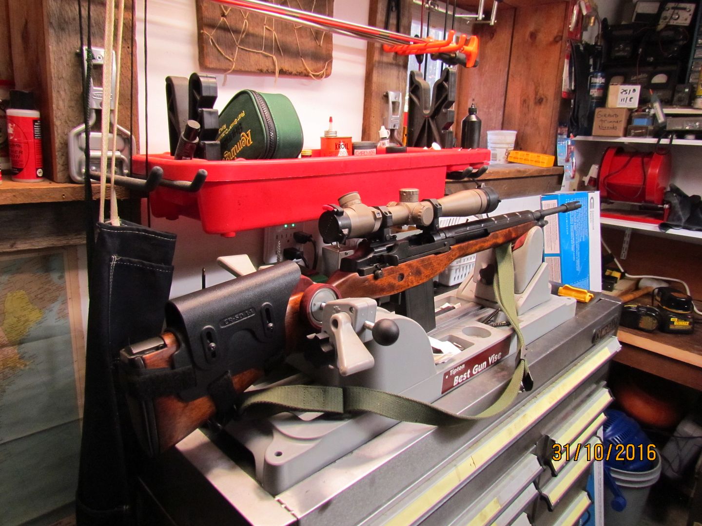

    Finished up XM21 #3 to her final configuration today.
    Bula XM21, Bula NM 22" barrel with Bula bolt,op rod, trigger housing and other small parts in a USGI stock $35. from CMP. Added a Hawk kit for appearance only. Scope is Leupold MK4 3.5 - 10 with lighted reticle. TAC-PRO cheek riser. SEI vortex screwed on end of barrel.

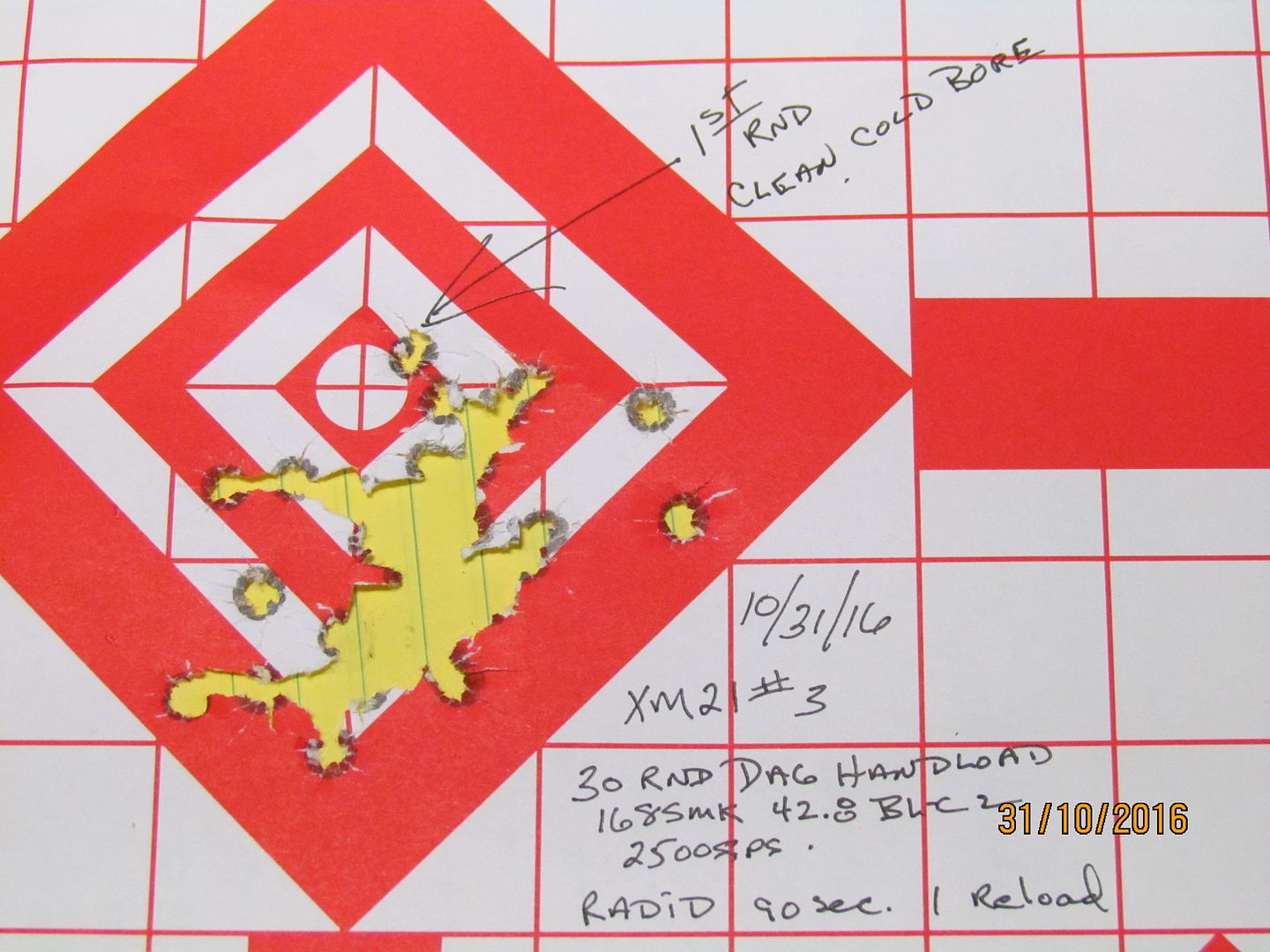

    Ammo used was DAG brass and Tula berdan primers with 168 smk over 42.8 BLC-2. Running right at 2500 fps.
    This test was done clean cold bore with rifle removed and put back in stock just before firing. Target is at 100 yards.
    30 rnds rapid , within 90 seconds with one reload at 60 sec. Extreme spread 3". First rnd is indicated on target. The whole intention of this build is to " Get Er Done".

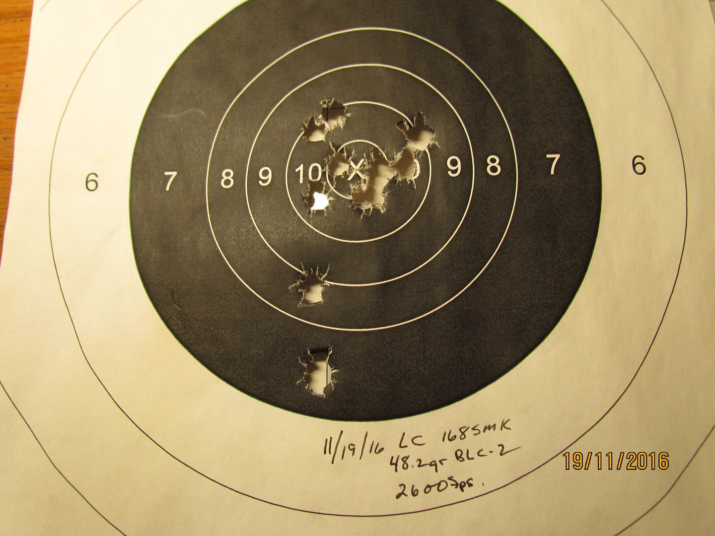

            Had a little time to play with XM21 #2 today. I had been using 168 GMM so my first two shots were low. After corrections, got a pretty nice 8 shot group in the 10 ring. Isn't that what we are supposed to aim for anyway. Just kidding.
