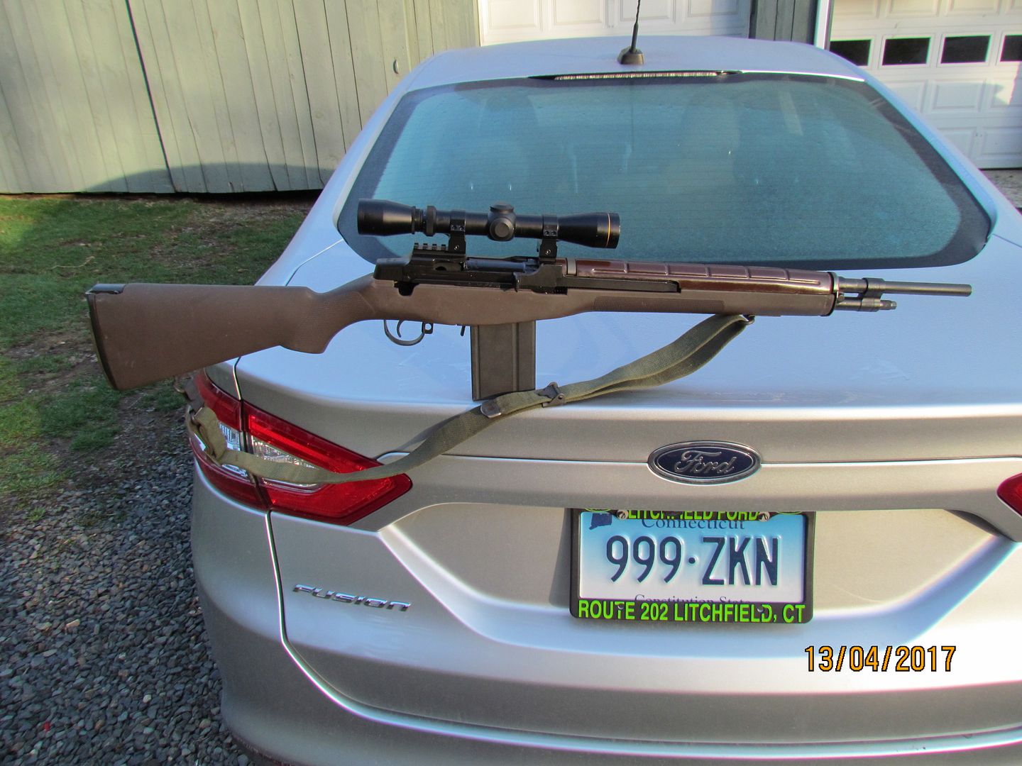

XM21 Hunter version.
    Just finished up another all Bula Defense XM21. This time it was decided to set one up for hunting. The 20 rnd mag is just for the photo. Hunting requires 5 rounder. Leupold 2 -7 should be just about right. Bula custom 20.5 NM barrel cut at crowned.

    How is the head space working out on all of your builds ?
      I have been reaming to 1.632 to 1.633 so they are working out nicely. The chrome lined barrels have been running right at 1.633 with no reaming as designed.

        5 Round magazine....figured you'd just single load one n done...Nice rifle

              Suspect you'll find the scope is far too high. Even with a cheek rest.
              Spelling and grammar count!
                Rgr that. That scope and rings are just a shop tool that gets clamped on all my rifles for function and test firing only. It was set up for a standard M-14 with a side scope mount and had to be that high to clear the rear sight. There will be a completely different setup for the finished product. This is one of mine set up properly.
