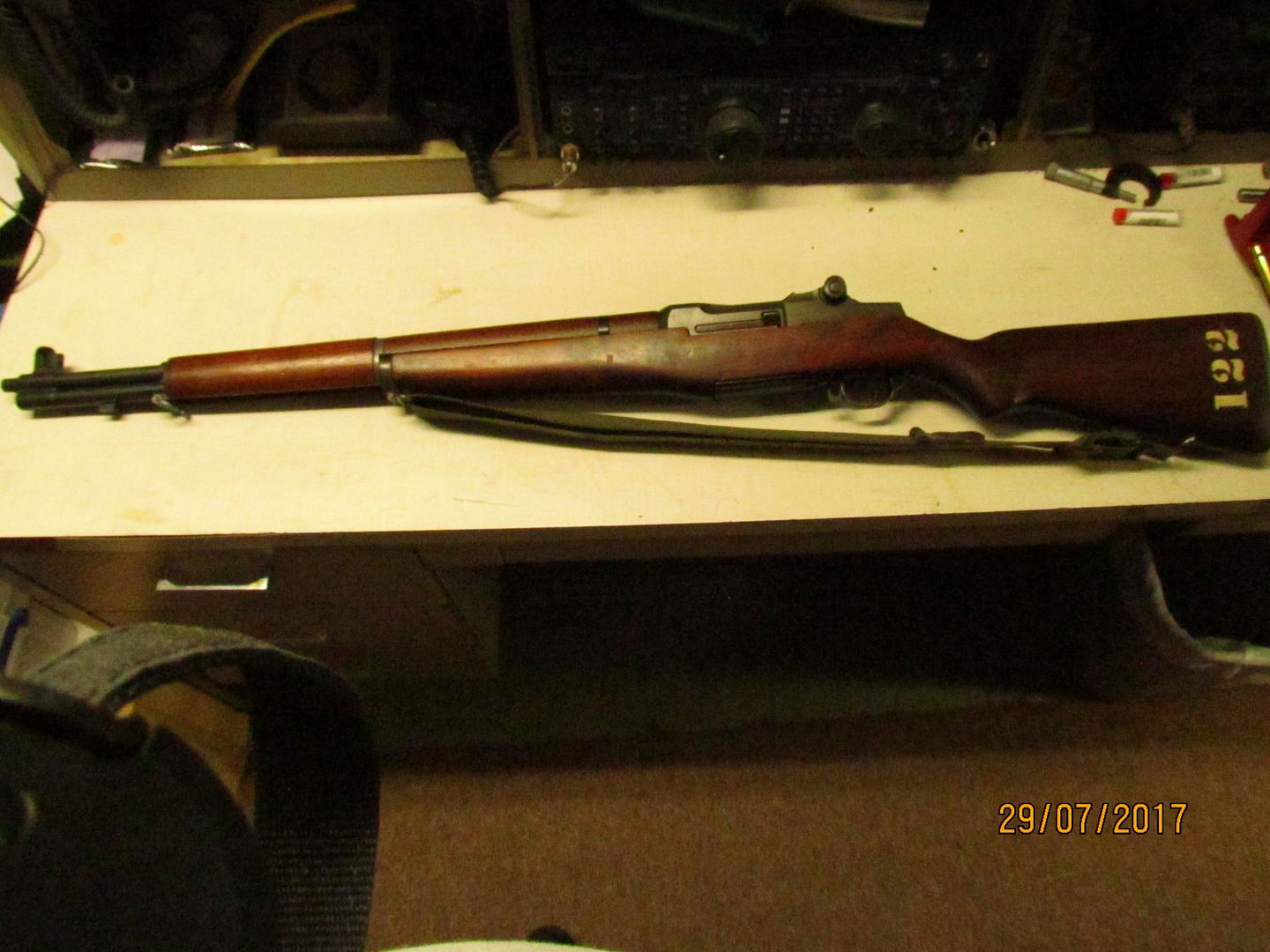

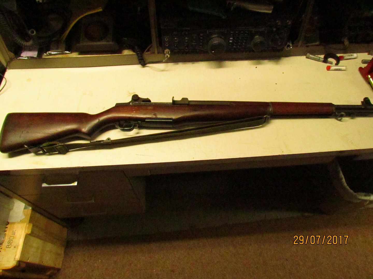

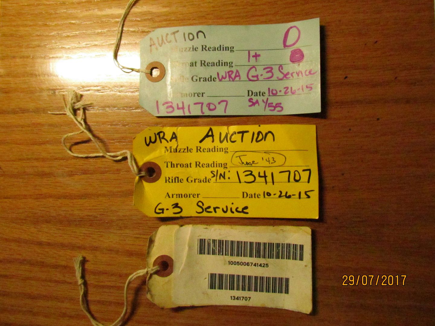

    Picked up one at North Store last week during games. The three tags caught my eye.

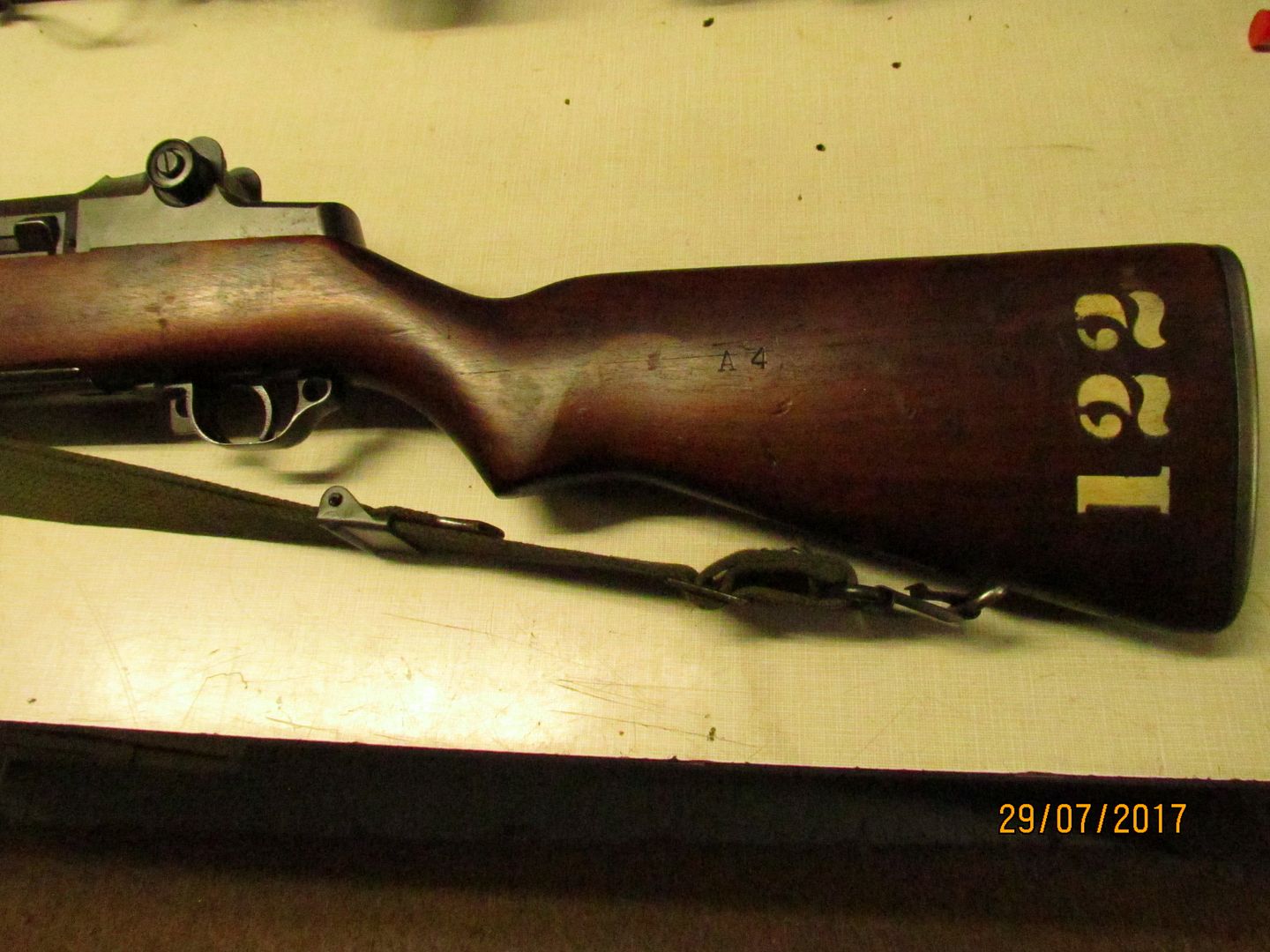

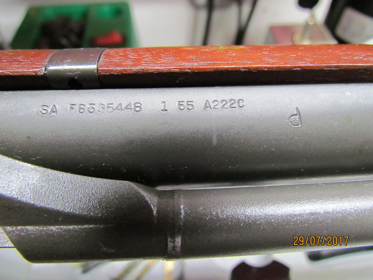

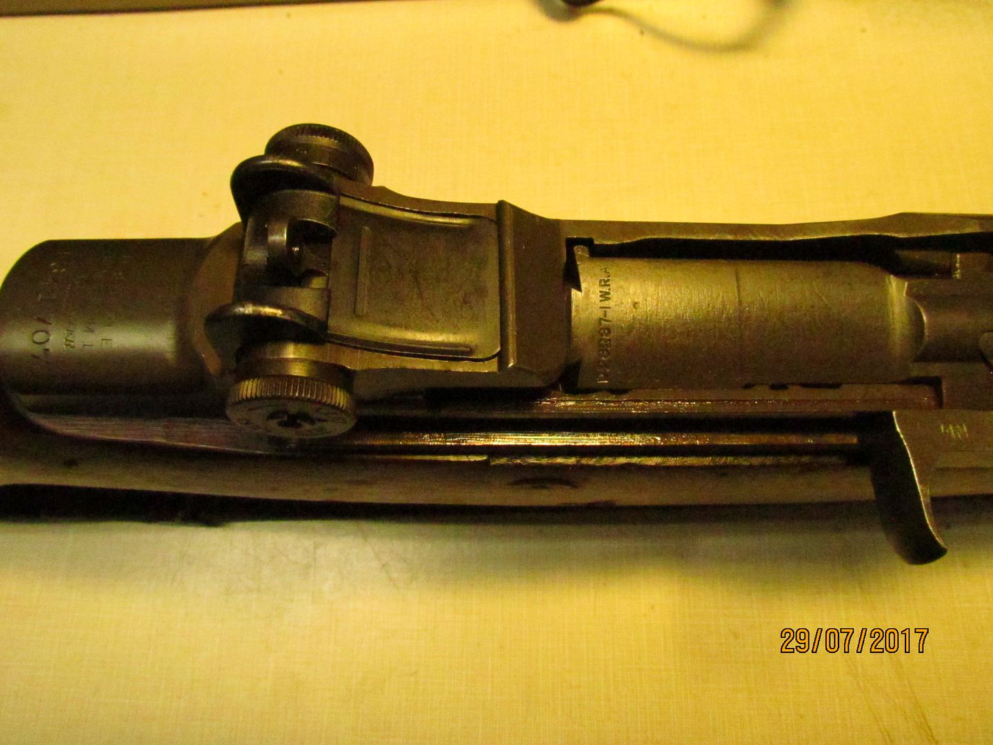

    GAW stock with A4 stamped in left side. Win trigger gp,RA op rod, SA bolt , hammer and barrel new 1-55.
    I have since changed out SA parts for Win except for barrel from tool box and headspaced.

      I believe that the 3rd tag with the bar code is an inventory tag used for accountability from the last government facility it was held. I think you can safely assume this one is not a foreign return.

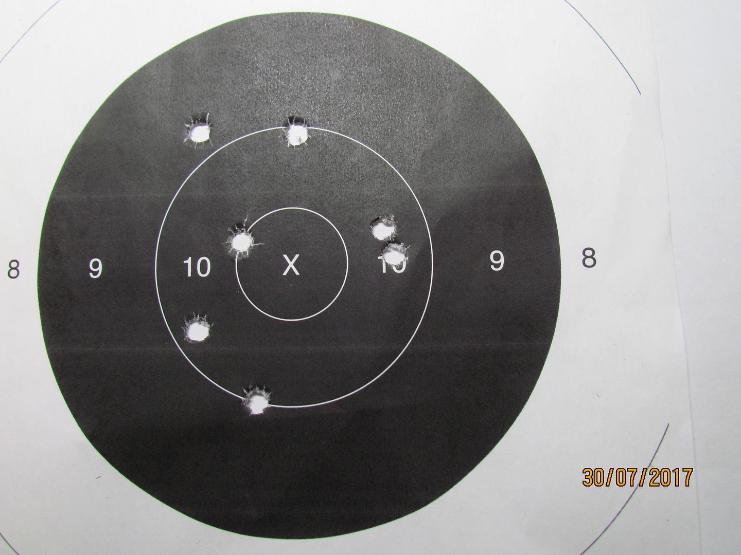

        Took her out for a little fun in the sun today.
        As it came from CMP raised ele. 8 clicks and win 3 right on 2x2 backer board.
        One SR-1 target at 100 yds 7 rnds of floor sweeping HXP. I am pleased.
