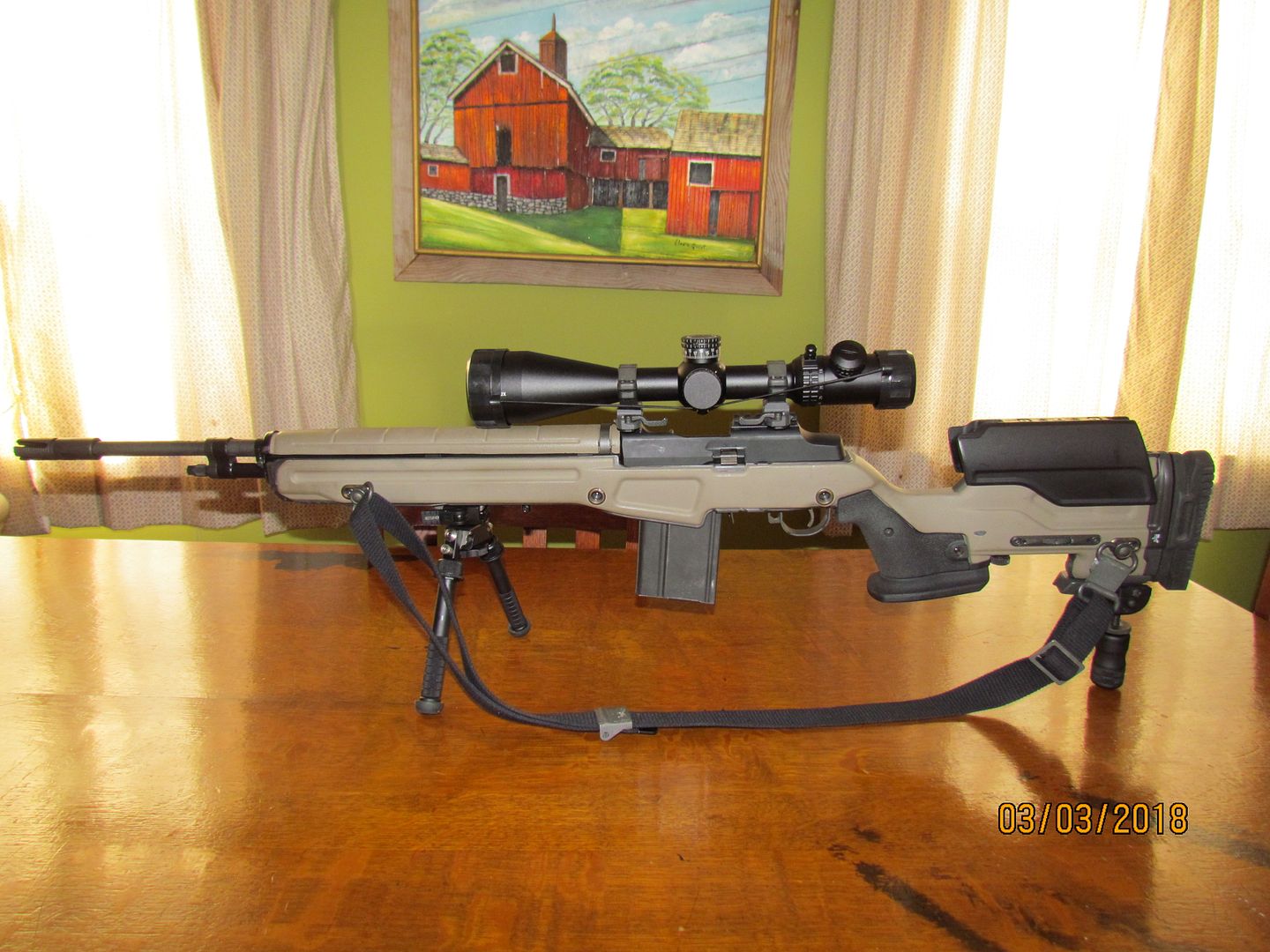

    Just finished up my first M14 in 6.5 Creedmoor.
    Bula Defense Systems XM21 with 6.5 NM Barrel.
    JAE gen III chassis with Atlas bipod and Accushot monopod.

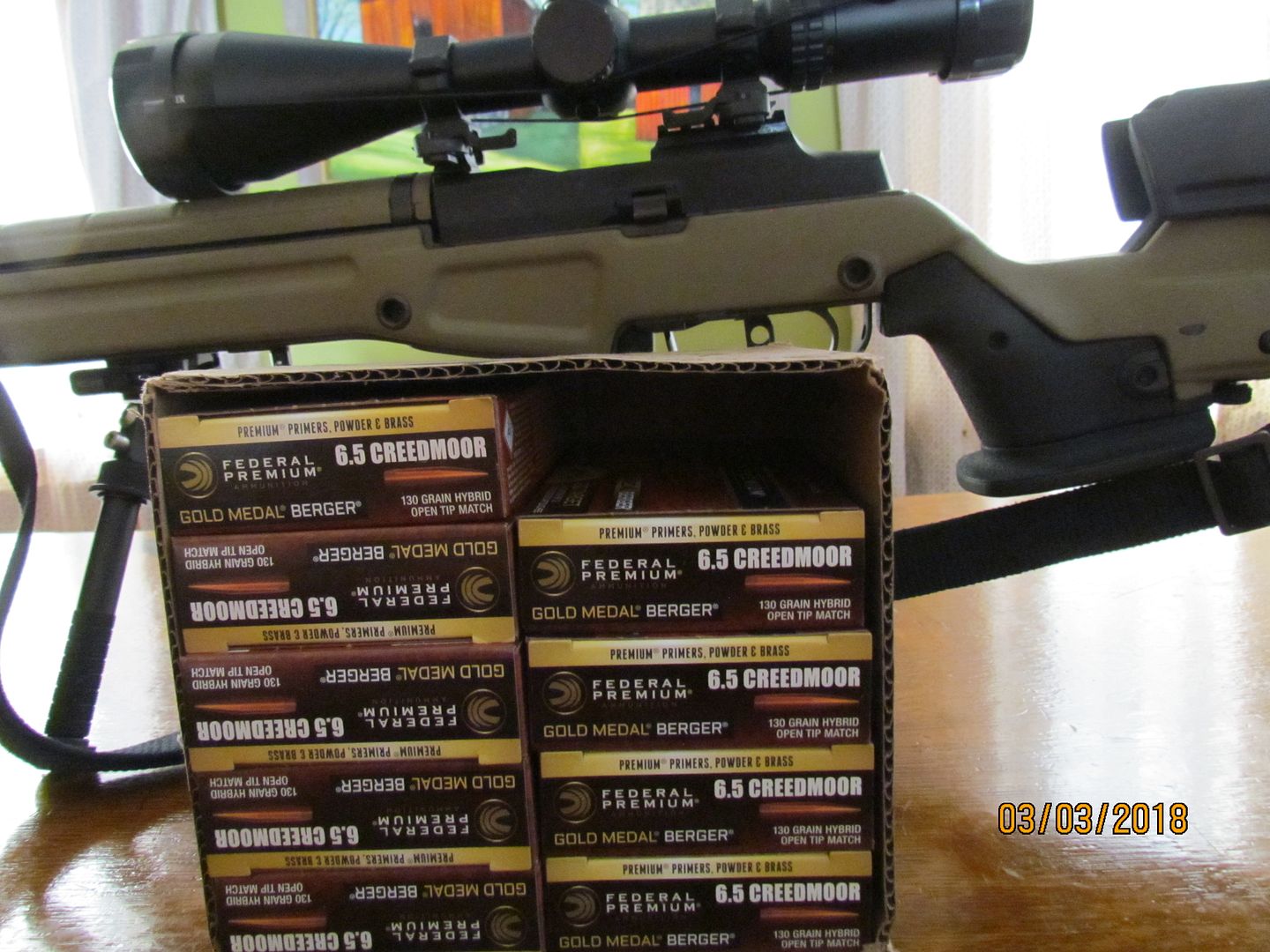

    Scope is a Hi Lux 6 - 30 56mm mounted with ARMS $22 30mm rings. Picked up a case of GMM 6.5 130 Berger to help set a baseline for accuracy. Looking forward to punching some paper.

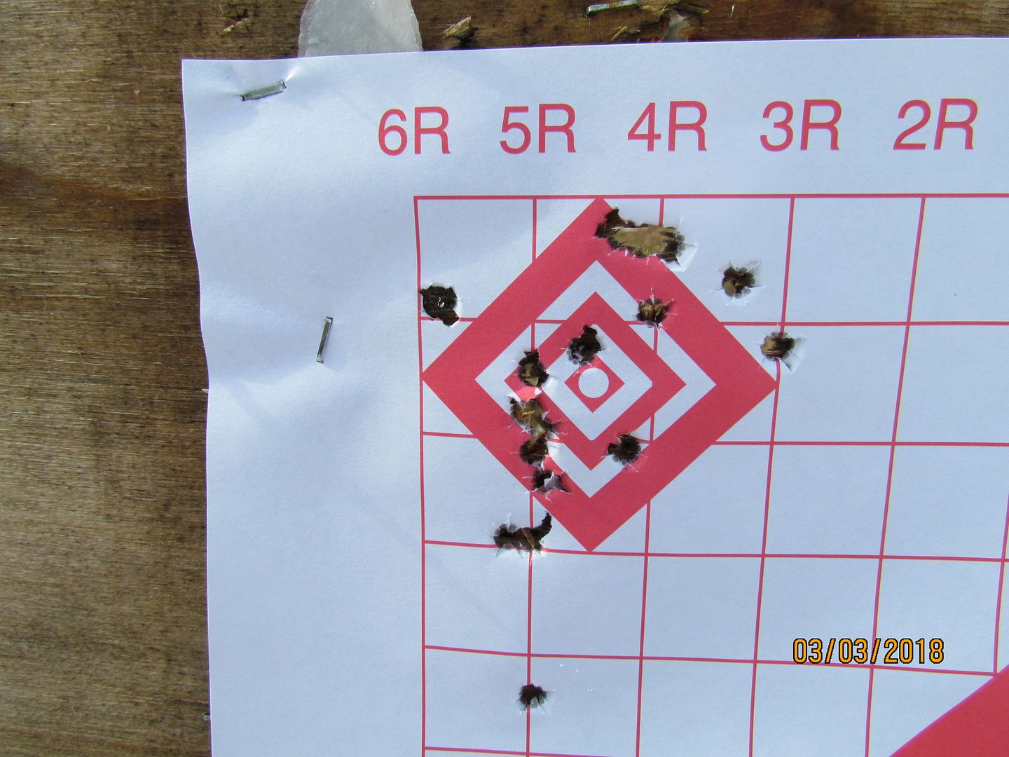

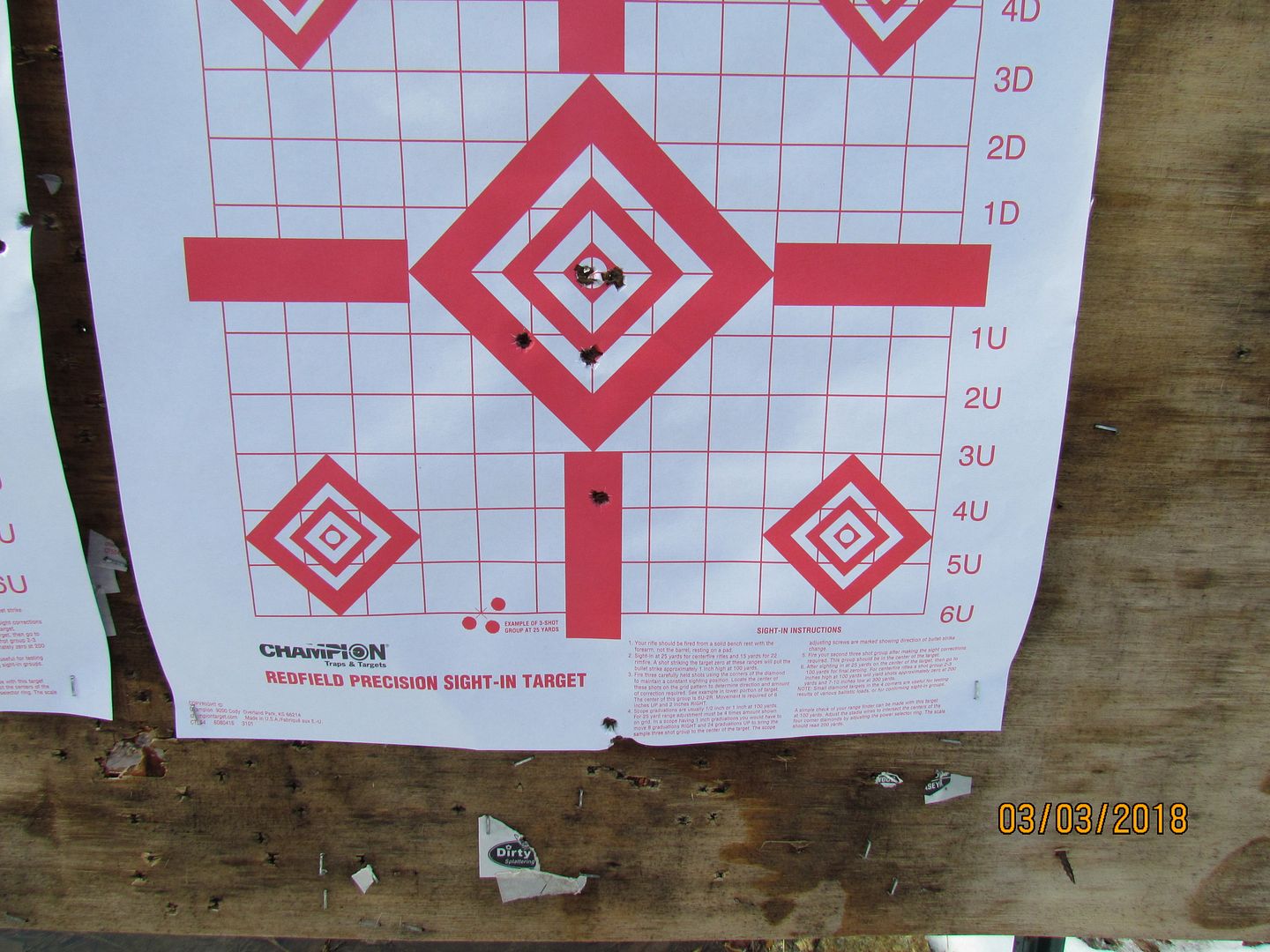

      Took her out for a function test. 100%. Rand 60 rnds of GMM without a problem.
      Target shows first 4 rnds from the new rifle a the bottom of the paper at 6. This is exactly how it was moving the scope from one XM21 to another. Needed no windage correction at all. Walked the elevation up for the 6.5 Gmm an settled in for a 3rnd group in the center. 100 yds target.
      Next target is an 18 rnd mag dump just to warm things up and check function. No problems at all.

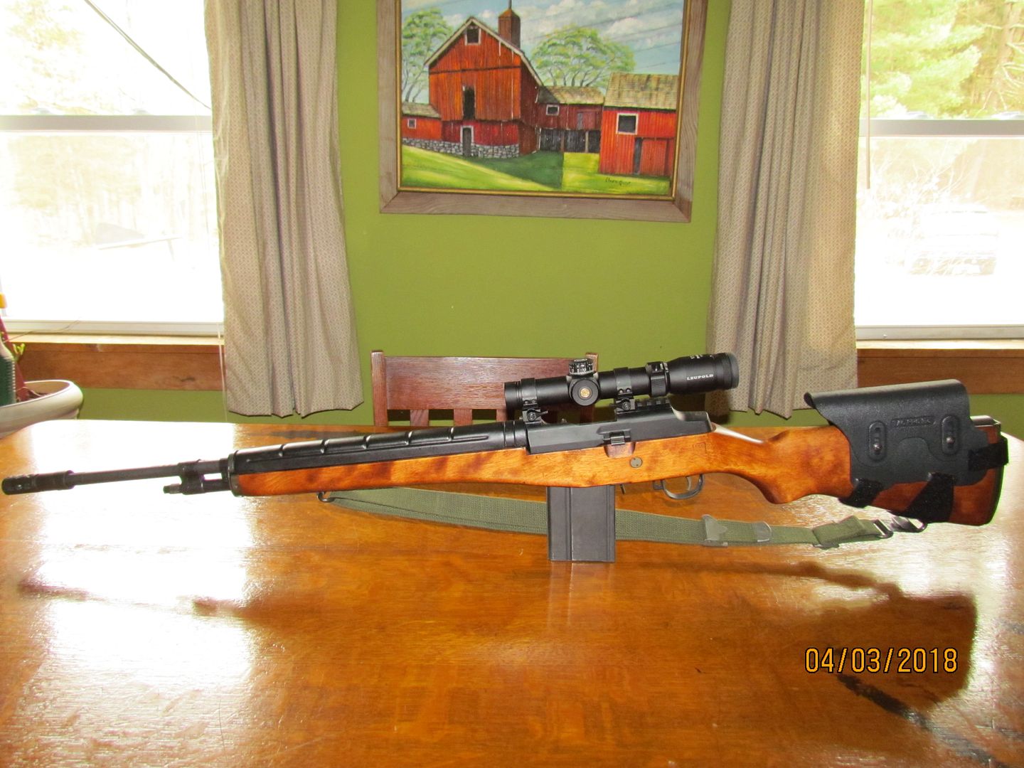

              Working on the second of the pair of XM21s in 6.5 today.
              This one will be going in the beautiful Walnut stock I bought at Wades last of the kind sale when she is completed. Until then one of my shop birch animals will do.
