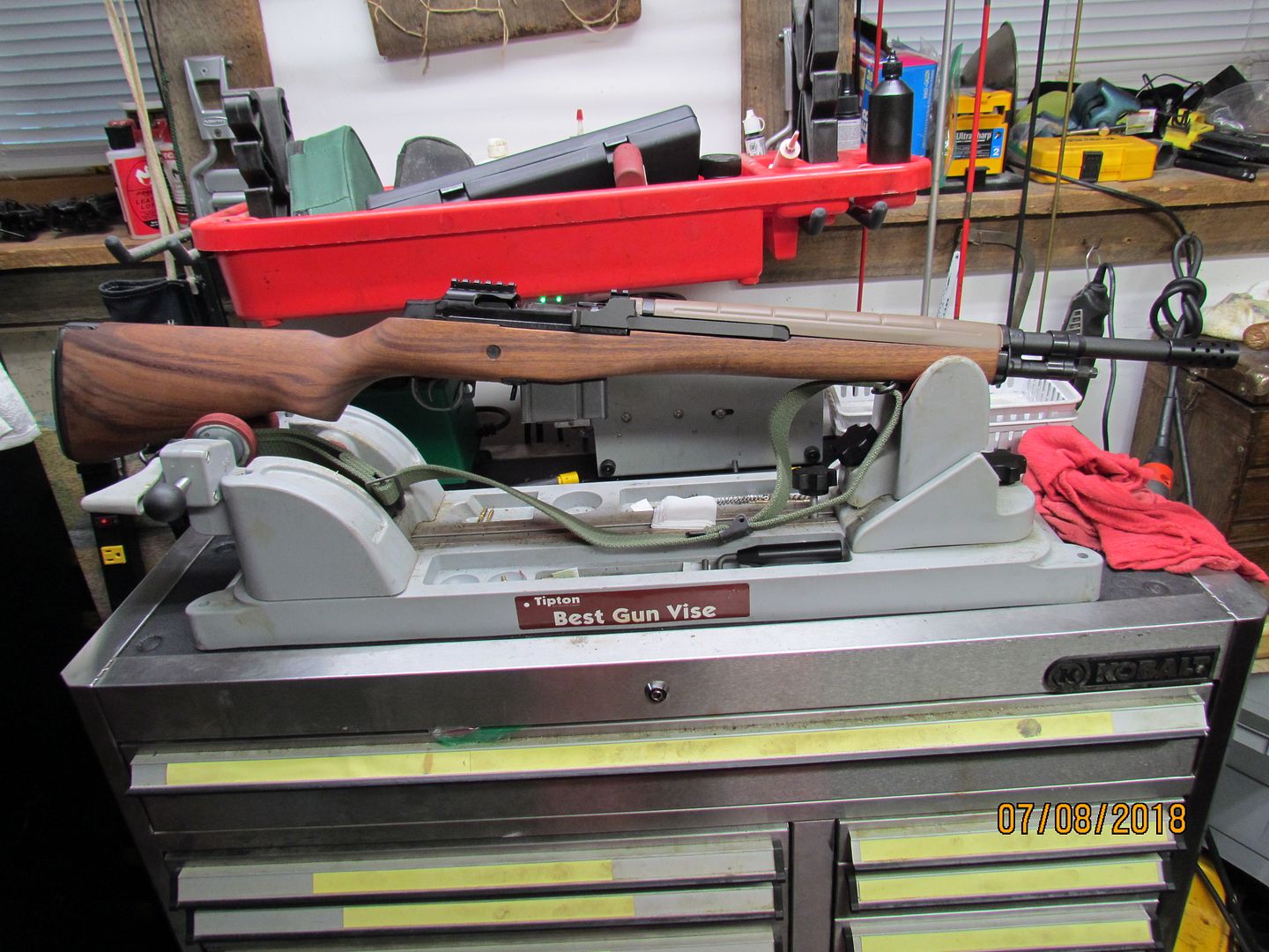

    First XM21 out in .450 bushmaster followed me home from Camp Perry this year. Looking forward to putting some " big lead" down range.
    There is a spare VXR-Patrol in 1.25 - 4 that is just itching to top of this big girl.

    Nice workmanship and an interesting caliber for M14 system. I have friends that have (and still do) hunt in Alaska
    and they tell me the best choice is the commercial Browning BAR in 338 caliber. The ballistic performance is better
    than the 450 Bushmaster and the semi auto Browning is very dependable under northern hunting conditions.

        nice stock on that rifle!
          Have to agree. It was on another rifle at Camp Perry. Jeff, the President of Bula Defense and I were chatting and he commented that he didn't care for the color, a bit lighter than what he prefers.
          I suggested that if he could make a rifle using the type of receiver I wanted and put it in that stock , I would buy it. Needless to say, the builder at the factory worked that day and delivered it to me the next day after he shot in the Garand match.
          I've been admiring it ever since. A little sandpaper and BLO and I think it will be exactly what I want in a thumper.

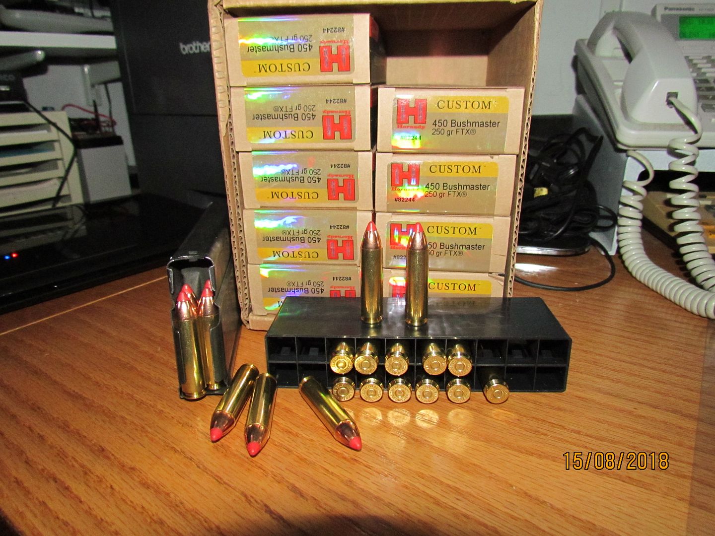

            Got my first case of Hornady ammo for Miss Thumper today.
            Hopefully, in the next few day she will visit the range and have a little fun.
            While I am at it there's a bunch of prepped Starlite brass in the dryer in the shop. Got the powder, bullets and primers ready to whip up a batch tomorrow afternoon.

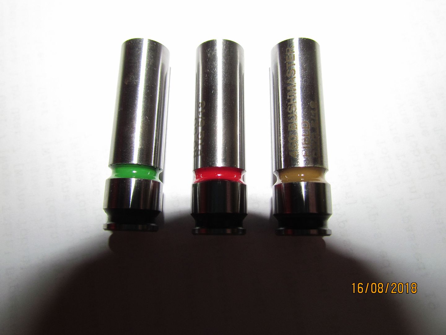

                    Trust but verity kit arrived from Pacific Too & Guage today.
                      Ammo and bullet comparison side by side.
                      Mouse gun on left, next .450 then 6.5 then .308.
                      ARs are available with uppers for .450 While M14s are good to go with .450, 6.5 and .308.
                      Other calibers are available , but these are mine and I am sticking to it.

                        Checked headspace with brandy new Pacific Tool and Guage gear.
                        First photo if field guage.
                        No/Go
                        Then the one we look for, the "Go" guage. Bout time huh?

                          Hard to tell even with the giant pictures. Might be the angle. Does that bolt close completely on the No-Go? If so, it means whoever put the barrel on really didn't know what he was doing. Isn't unsafe, but a good smithy would have fitted the barrel so it does not close on the No-Go, not the Field.

                            Bolt only closes completely on Go guage. No go is up 1/8 or more and field is way up same as I set up my .308s. The guy that put mine together knows his stuff. I put the trust but verify in there because Ronald Regan was one of my heros and I always liked that statement.

                              "...No go is up 1/8 or more..." It's the picture. That's perfect. The operative word is 'completely'.
