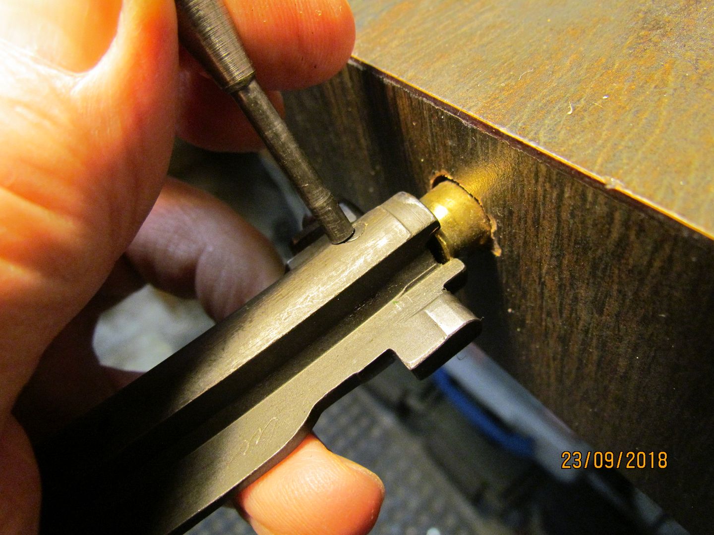

        The tool for both M1 and M14 bolts is the way to go for ease of use. I have had a cartridge case drilled into the side of one of my benches for over 30 years for quick and easy disassembly/assembly. I just press the bolt , with the extractor base up, against the cartridge base to relieve pressure on the ejector spring and push the extractor out with a small punch. Just the opposite for installation.
        These days I have been using the commercial tool so much that I almost forget what the cartridge sticking out the side of the bench is for. Memory is such a small thing.
