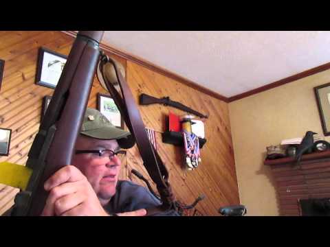

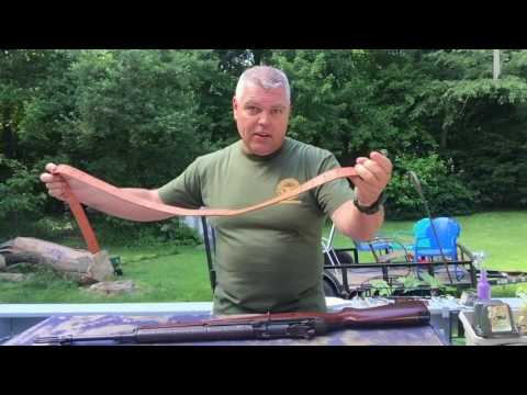

                            I know I am resurrecting this thread, but I used my Garand and my 1903A3 in a recent match and thanks more or less to the videos below, I think I am finally comfortable with my M1907 sling. For future searchers:
                            Both served in the Marine Corps when they were younger. Respect...
