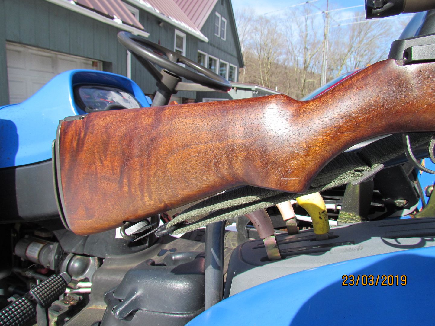

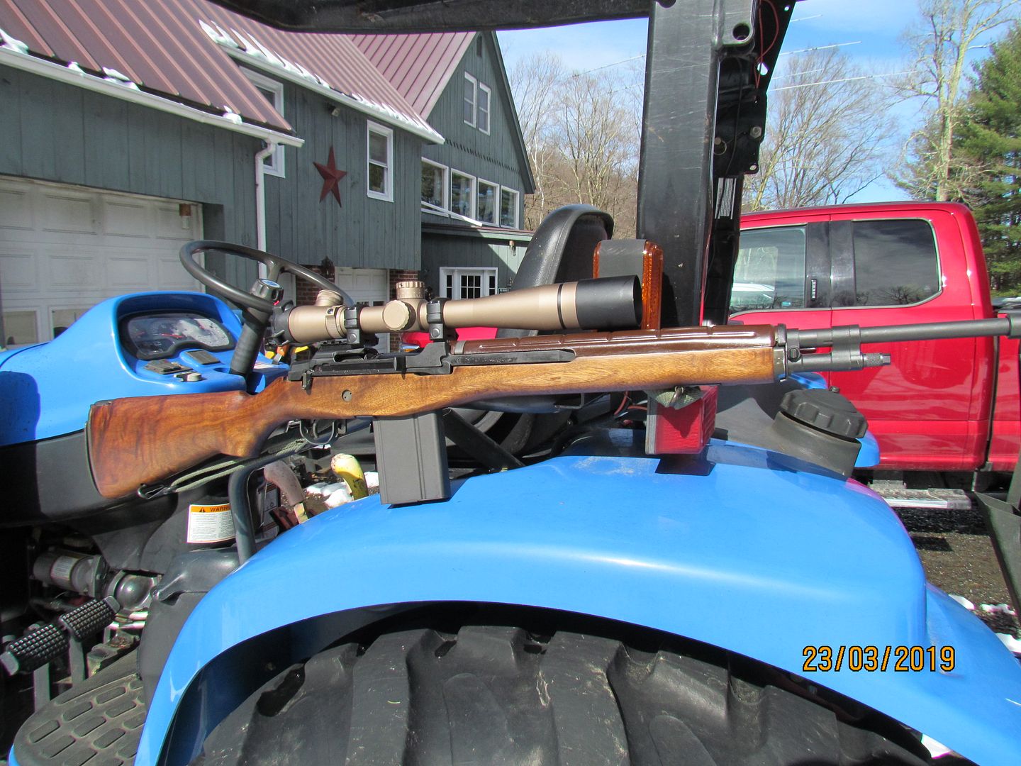

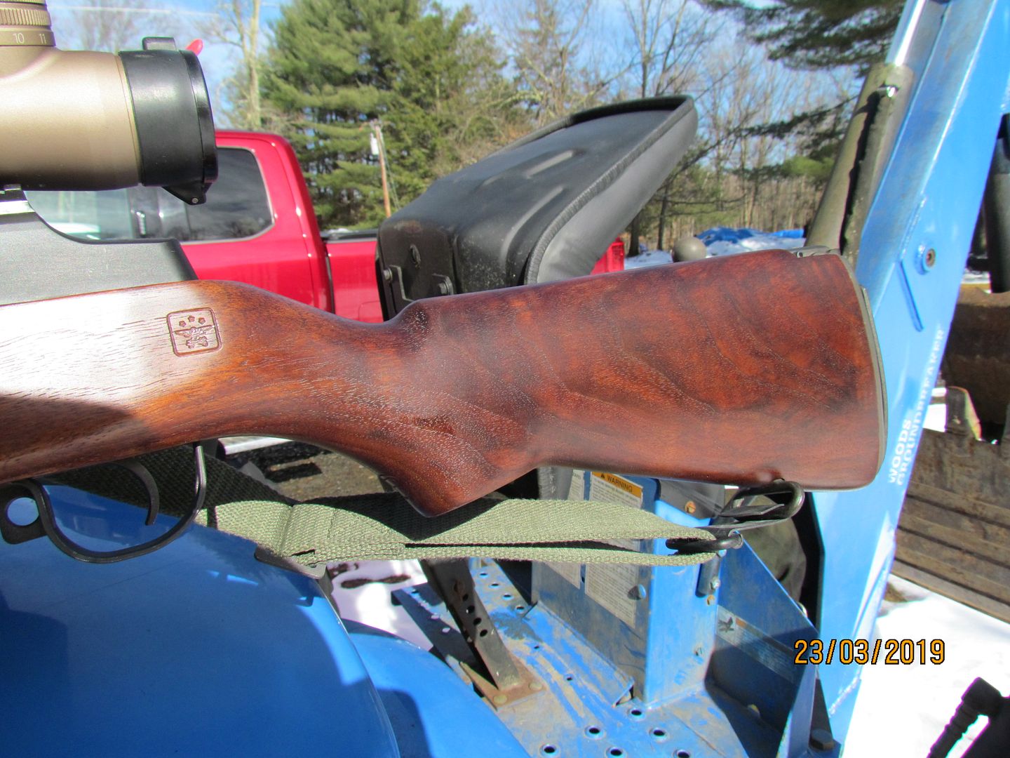

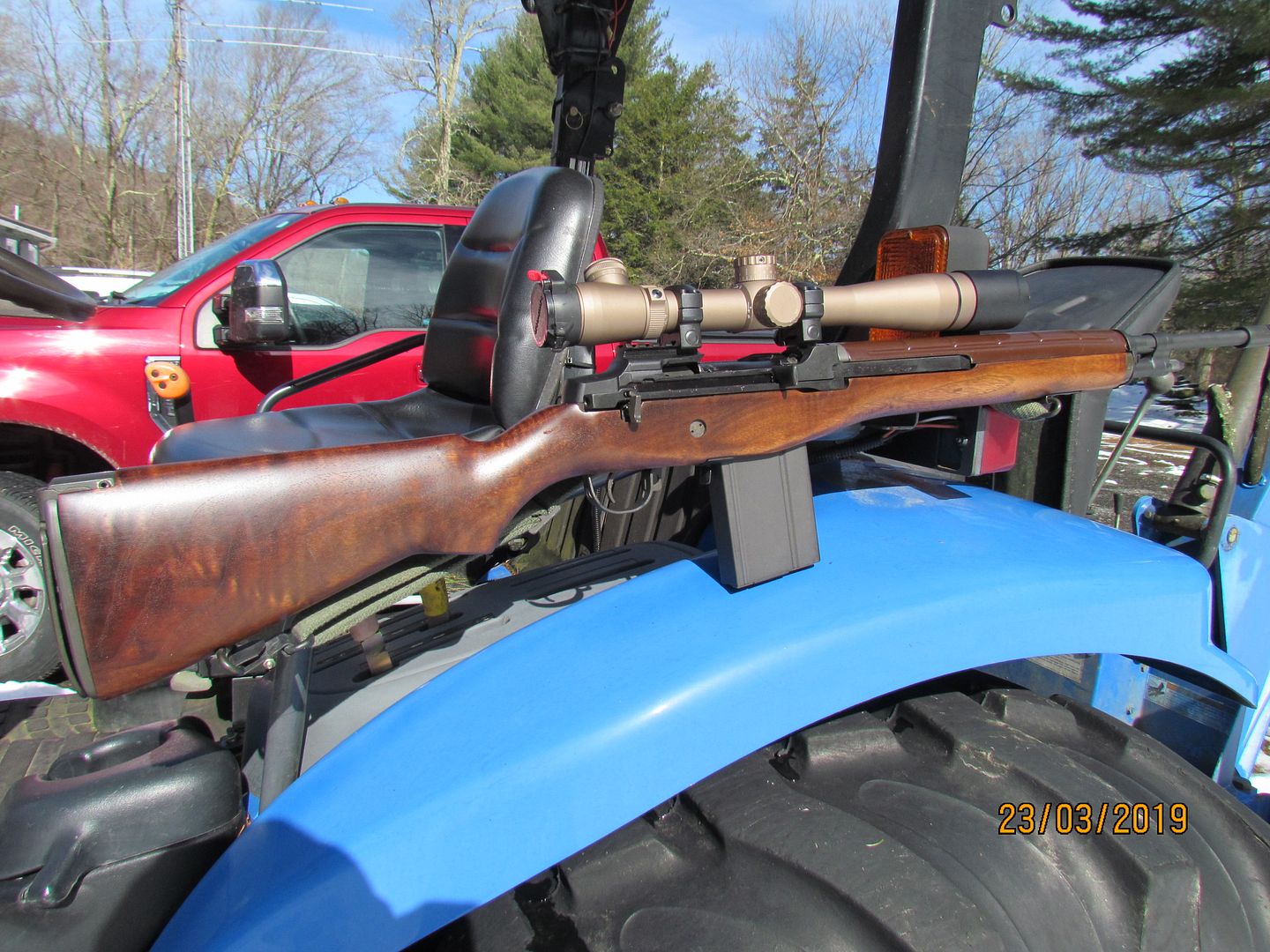

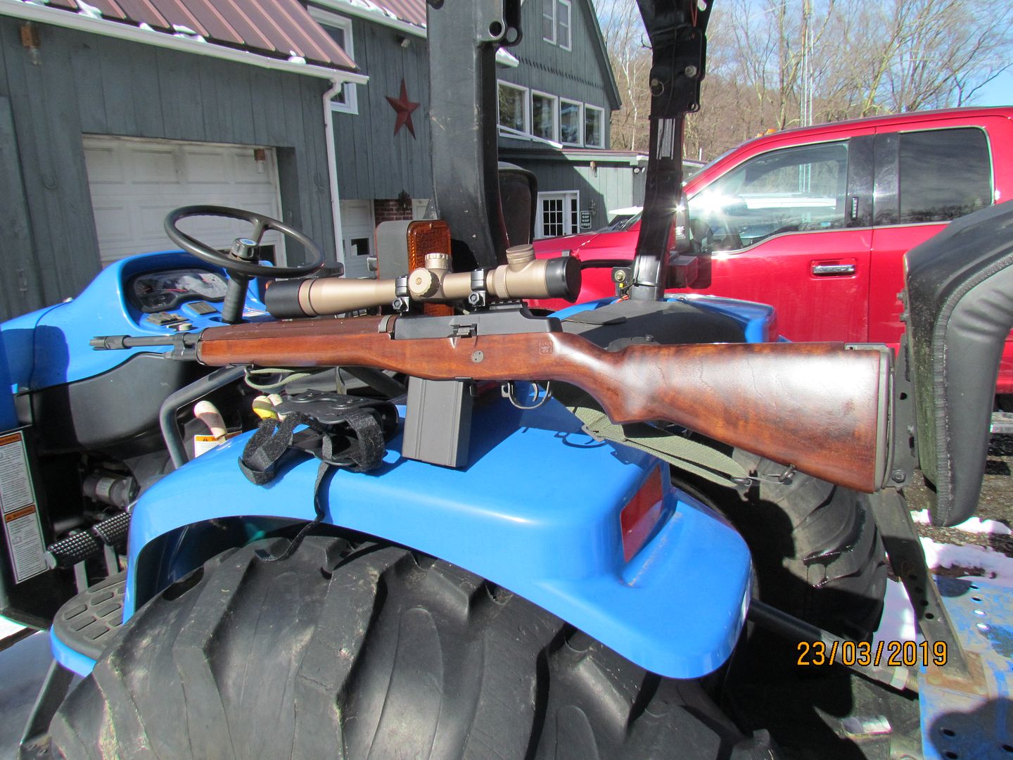

    Took just over a year, but finally got Silvassa ready for sunlight.
    Stock is one of the last that Wade was doing. She has been sitting in the shop just itching for an action.
    Well , today is the day. Bula Defense Systems XM21 6.5 Creedmoor.
    22" 6.5 NM barrel. All Bula parts. Scope is Leupold MK 4 3.5 - 10.
    Cheek riser is Tac-Pro strap on. Off for photos of stock.

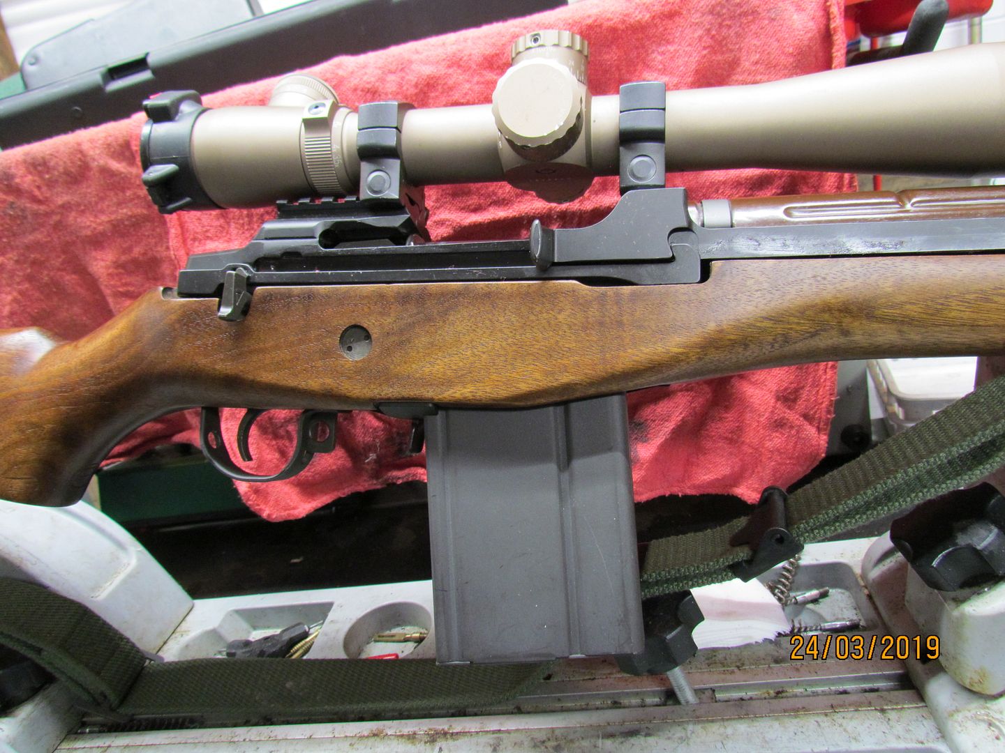

          Very poor results with the rifle in that stock. Just would not settle into better than 1.5" at 100. Put it in a GI fiberglass and about 3/4" groups. Back to the drawing board.
          Looks like the dickens was filled out of the stock liner before I got it. For now, the stock is going back on the rack. Will make another attempt after I replace the liner. Pretty, but not a shooter at this point, and if it don't shoot, it's firewood.
          Some you win, some you loose, others just flop around looking stupid.
            Guess it needs to be bedded but then you can't readily change out the stocks which is a perk of the M1A's.
              Will probably go in a JAE chassis which will take it down under .5 moa.
              Only 1 of my 3 doz plus M14 type rifles is bedded. Don't plan on ever doing that to another rifle.
              Modern chassis are the solution for precision out of the M14.
