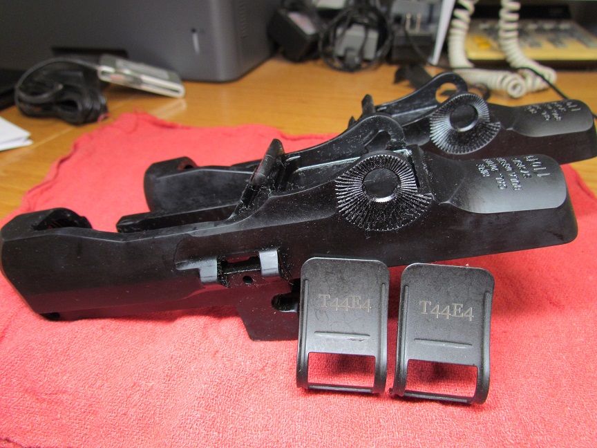

Receivers for Winter project arrived this afternoon.
    Just received a couple of receivers from Bula Defense Systems for use in Winter builds this year. There are a couple more of a different type on the way also.

      Just intending to nail a couple together as close to original T44E4s configuration as I can. Mainly additions to my collection of something I don't currently have.
