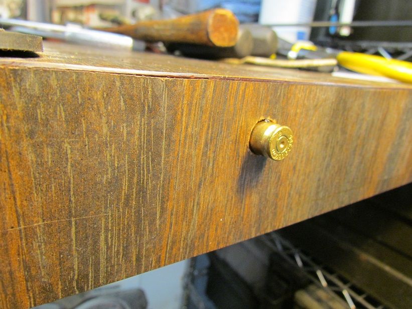

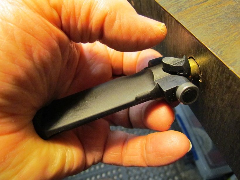

    Most often used tool is a spent casing drilled into the side of my standing workbench. Cheap, fast and it's always close at hand. Start with the extractor facing down, compress the ejector spring with the palm of the hand and using a small punch, push the extractor shaft down and the extractor should just drop out. Putting back together , naturally, the extractor is easiest to install from the top down. A couple of times using this method and it becomes second nature.

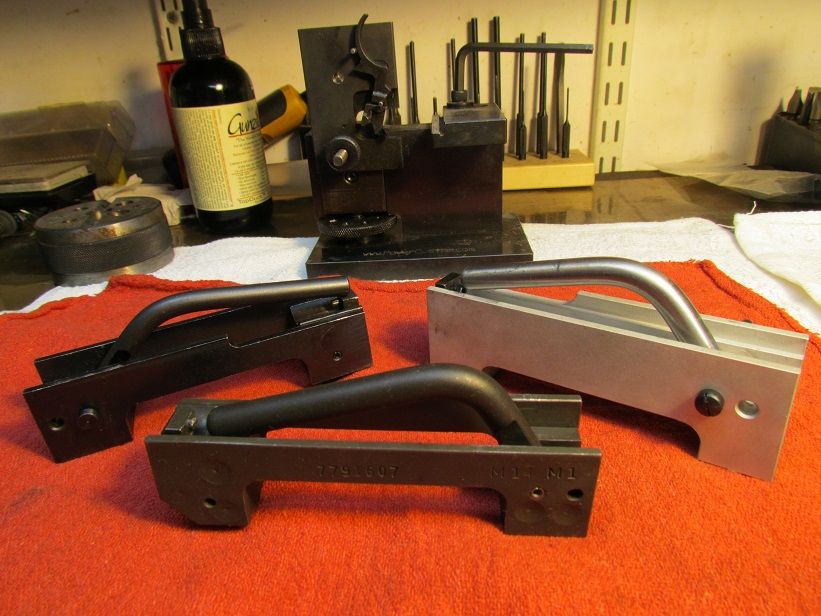

    Then of coarse there are always these gadgets close at hand. Just remember when using one of these, hold it in your hand and not on the bench because that will depress the extractor removal button and make putting the bolt back together a real pain.
    I have one or 2 of the GI units ,
    I have also used the cleaning rod handle ,
    stick a rod handle in the vise and it works as well as that table top method, (ingenious by the way)
