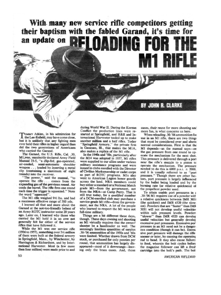

Want to buy a M1 Garand barrelin 7.9mm, who to contact?
  • jjrothWA
    • 1148
    Want to buy a M1 Garand barrelin 7.9mm, who to contact?
    Acquires some7.9mm ammo and want to try using a Garand action, should be VERY INTERESTING, I think??
    Thanks.
    • 3761
    Probably will end up having to use a surplus .30-06 barrel bored out and rifled. Of course you'll also have to do something w/ the chamber. However, good idea as the 8x57mm is a wonderfully effective cartridge. If you have access to a sufficient quantity of ammunition, it'd be a fun conversion. With a adjustable gas plug you would have no concerns about port pressure, etc. Good luck! Sincerely. bruce.
      Originally posted by bruce
      Probably will end up having to use a surplus .30-06 barrel bored out and rifled. Of course you'll also have to do something w/ the chamber. However, good idea as the 8x57mm is a wonderfully effective cartridge. If you have access to a sufficient quantity of ammunition, it'd be a fun conversion. With a adjustable gas plug you would have no concerns about port pressure, etc. Good luck! Sincerely. bruce.
      sleeve a barrel blank in 7.92 in a bored out Garand barrel shank , (the way 1903 barrels were done to fix a garand in the 50's and 60's)
      douglas etc may make one up for you ,
      • Sunray
        • 3251
        Any surplus .30-06 barrel bored out and rifled would cost a fortune.
        Google is your friend.
        Go here. Ready to install 8mm Mauser M1 Rifle barrel $409.00 USD.
        Last edited by Sunray; 11-13-2020, 08:49.
        Spelling and grammar count!
        • k arga
          • 566
          What about 35 whelen ,jes can rebore and he is in your neck of the woods.
          • M1Garandy
            • 611
            You can get barrels new in .35 Whelen too: https://criterionbarrels.com/product...v=00dc5da36527
            • Hal O'Peridol
              • 929
              Here ya go:
              Enfield, everything else is just a rifle. Unless it's a Garand.
              Long pig, it's what's for Dinner!
                I would wonder about port pressures, as a lot of 8mm projectiles run 190-200gr. Presumably lothar-walter has tightened up the gas port orifice for that reason. An adjustable gas plug would seem a must.
                Dayum....I have a CMP bare receiver....
                • Sunray
                  • 3251
                  Port pressures? I've used 220 grain Silvertip(semi jacket with the Al cap. They did astounding things to a ground hog.) bullets out of my rifle with no fuss. Wasn't many but there was absolutely no damage. I've never, in 40 some years, seen a rifle damaged by the ammo. One would think JC, who tested the rifle with up to 120,000 PSI Blue pill proof loads, would have mentioned it if there was such a thing. One would suspect a 120,000 PSI load would have much more than 6 to 8,000 PSI port pressure.
                  Read the right hand column here. (It used to be the whole article. Seems Scribd thinks you should pay for it now. There's a free trial link about half way down.
                  The NRA load data that's below the first page has 200 grain .30-06 data. Why anybody'd want/need 200 grain data for an M1 is a mystery.)
                  Spelling and grammar count!
                    It's not hard to see the issue.
                    Heavy bullet means slower powder to keep the chamber pressure down. Slower powder means delayed pressure pulse, with less dropoff by the time the bullet clears the gas port. More gas energy delivered to the op rod means a bigger impulse. A bigger impulse means more unbalanced forces at the bolt camming recess (off the centerline of op rod travel), and a harder landing of the bolt at the rear of its travel.
                    Remember, K (kinetic energy) = 1/2 * mass * velocity^2. That is, double the velocity of a moving component, and the energy needed to accelerate or decelerate it goes up by a factor of four.
                    And there is a range of powders that are recommended for the M1 Rifle.
                    Sure, someone can ignore all of that, say I've done it this other way for years, no issues, but one man's experience with one rifle is not representative of the family, being a rather small sample size.
                    Last edited by togor; 11-16-2020, 06:10.
