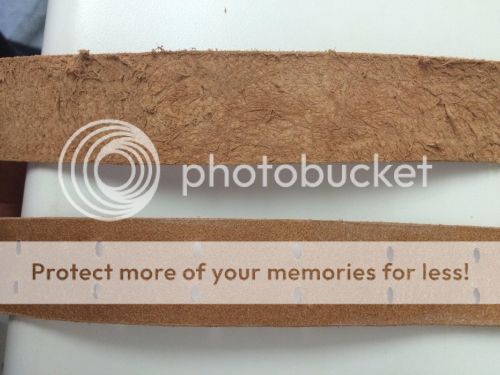

    Picked up 2 NOS USGI M1907 slings that were still in their original packaging, one marked MRT 10-86 and the other is unmarked but it's packing slip is dated 7-66. The leather is dyed on one side, but not sealed, and both appear to not have been touched/handled since they were put into clear plastic packaging bags.
    How should I treat these slings? I have some clear (kinda milky-white) Danner boot dressing and some Bee Seal Plus boot protector that's yellowish in color, both wax based products I believe, is that the way to go? Also, looking at the picture below you can see one of the slings, the MRT 10-86 marked one, is rougher on its backside then the other, what's the best way to smooth it out like the other sling, can it be smoothed out w/o shredding the leather?

            Anyone know if there's a way to knock-down/smooth-up that rough hyde?

                Leather shops and there is a mail order company, sell a tool to "burnish" leather which seems yo have been done to one of yours, the other is really "fuzzy" tho, so some other process may have to done first.

                              As some suggested, use Pecards and don't use it on the rough side. Apply several thin coats rather than one heavy coat.
