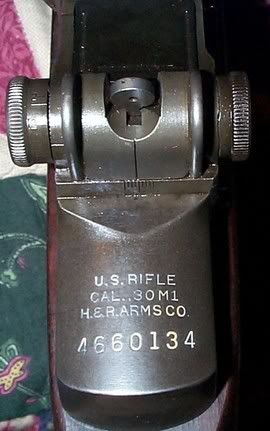

      Well I got this one
      In this very early HRA from the CMP
      I am not sure when they quit using them it but would probably would have been in most of at least the first couple thousand.
