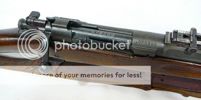

    Here are two Marine rifles with 1941 dated Sedgley barrels.
    Here is the magnesium.
    Here is the zinc.

                Originally posted by bombdog
                Okay, the color on 'maureen' is about the same as the second picture... i don't have color photo options as i don't know how to post them on a 'tablet' yet... Sorry, i'm teknologikly challenged... What color is the front band on those???
                Her sr is 432058... The bolt is 1010207...
                bombdog...
                This is the band on the lower one. I do have one about 400 digits off your 432xxx, but that is close as I have. The interesting thing is, the first big shipment the Marines received of 1903's happened in 1910, with a larger one happening in 1911. I have one serial about 300 off from your bolt. I will keep a look our for you serial though. There is a chance I might find it, as I'm finding a lot of low number Marine serials, especially in that 400k range. And a lot of those Marines seem to be WWI vets, so this might be a really interesting one to hold onto.
