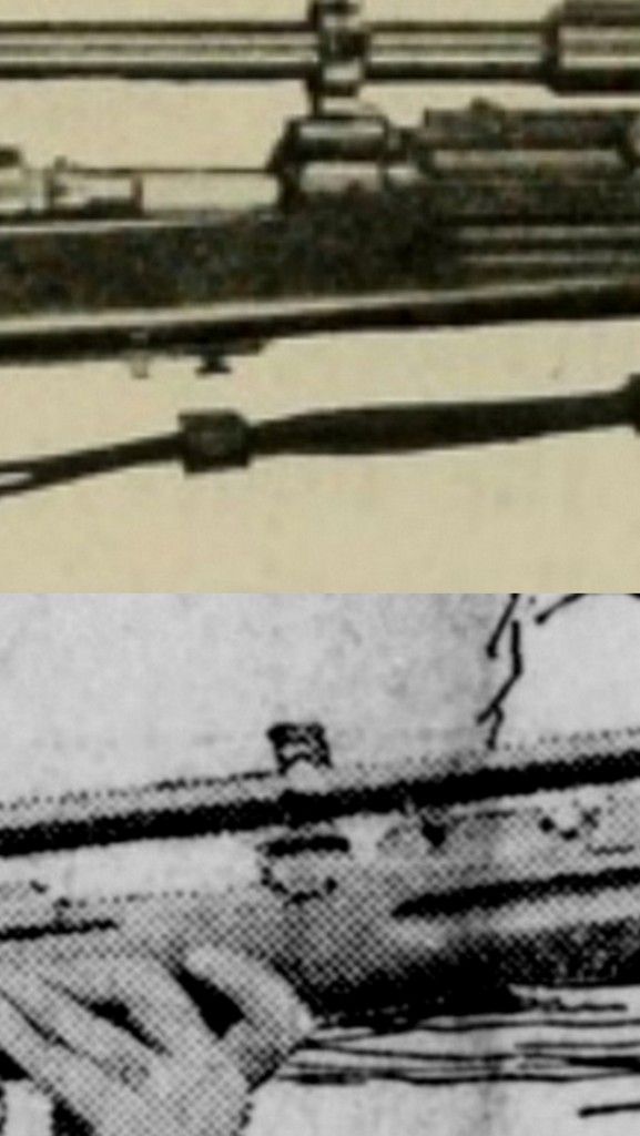

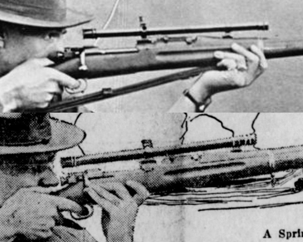

          I have found out more details behind the the first two pics above, that explain where they were taken and when. But some of it is not my work, so it's not mine to say. But both pics are in France during the war.
          Also I do not think the newspaper clipping rifle is a Mann Niedner. That I found, so I don't have a problem commenting on it. The blocks on a Mann Neinder are much larger, and for example, the rear block runs the whole length of the receiver. You can see that in the photo above of a Mann block. Where on the newspaper receiver you can see the block does not run the full lenght of the receiver. There is a space between where the block stops and the rear sight base. The handguard also seems the wrong style for a Mann Neidner as well. I do not think that handguard has enough clearance for a Niedner style tappered mount to slide onto a Mann style block.
          Remember the Mann Niedner style blocks slide on from behind, they do not go on from the front like the most forward Winchester blocks does. That is because the Mann tappered blocks tightened under recoil.
          When you look above at the pics, you can clearly see the Mann blocks go on from behind in the one pic in France. And you can also see how the block is the full length of the receiver. Now look at the Mann Niedner handguards in the school pics, and see how much they cut off the handguard so they could get enough clearance for the mount to slide onto the block from behind? I just don't see that same modification on the newspaper handguard. I don't think there looks like enough clearance to do it.
          Also if you read the description on the side, it says it is easy to put the scope on the rifle and easily de-attached when not needed. I do not think anyone would claim the Mann Neinder style scope is easy to put on or take off. When you put that scope on, you have to fire a round to get the recoil to tighten it. When you want to take it off, you have to pound it off with a hammer and punch.
          The normal WRA style just slides on and off and is tightened with a thumbscrew. Which I would imagine what they are detailing in the descritpion.
          It could be a better quality picture, but I do not think it's a Mann Niedner Rifle. And putting it next to the WRA style in the photo above, I think it looks almost identical to the WRA style.
            Look very closely at their uniforms. I believe the first picture was taken in the states, but the second picture could have been taken in either country. The two young men are part of the 5th Brigade, which was awash in OSD trained snipers with WRA Mann-Neidner sniper rifles, all too late for the war.
            The bases are too large to be #2 bases, which are quite small in comparison.
            I found it also. It wasn't difficult.
            Anyone who owns one of these scopes on a Mann-Neidner base will know the movement to the rear to unlock the base is not the length of the base. It is a short movement. I have observed differing lengths of Mann-Niedner bases, as have others.
            I deer hunt with an A5 scoped Sporter in Mann-Niedner mounts. I don't note much tightening under continued recoil. I have a little wooden slat that I use to give a light bump on the front of the front base which will disengage the front base with ease, repeat with rear base. Ease of removal is the beauty of all my A5 scoped 03's in Mann-Niedner bases. If you take one to the range, scope unmounted, and just shove it on, the first shot is typically spot on. After a shooting session, bump the bases, remove scope from the rifle, and you are ready to go. I do not store my rifles with their A5 scopes on them.
            Sure there is.
            Good grief! Who told you that? For goodness sake, please don't pound on that scope or its mounts. I wrote the previous description of mount and dismount before I read this bit. Please people, don't hit your scope bases with a punch and hammer. The mounts lock with a simple little push onto the bases. In years of hunting in heavy brush, I have never had mine loosen. You can repeatedly take the scope on and off without lose of zero.
            On the other side, I doubt I am the only one who has had hell loosening that #2 mount locking screw. If not pretty tight, it will come loose.
            By WRA "style", do you mean #2 mounts? The first picture below is an '03 with #2 mounts and bases, the second is an '03 with an A5 in Mann-Niedner bases. Look closely. You are missing something.

              The top pic is an Army AEF Signal Corps Photograph taken in France and is able to be pulled at the National Archives. It is titled as a Marine with Telescopic Sights in France. You are more than welcome to pull the pic and file from the Army AEF files yourself if you don't believe me.
              My explanation on the Mann Niedner scope attachment and removal was taken from the actual Marine Corps documents on how to mount and dismount the scope. That is what they detail to do.
              I don't think I'm missing anything in the pic. There is a explanantion for the knobs that I found digging in the Winchester files, and I suspect that is what you are hinting around when you tell me I am missing something. I already factured that in.
              This is about as clear as I can get in the size different between the blocks on the newspaper rifle and the Mann Niedner style tappered blocks. The top rifle is a photograph of a Niedner commercial rifle with a set of Mann tappered blocks. It's the same style and size of blocks that you see on the Marine Mann Niedner rifles. It's the perfect angle to show how much larger the Mann Niedner style blocks were to the blocks on the Newspaper clipping rifle.
              Putting Mann Niedner blocks side by side with the pic, there is no way that newspaper clipping rifle has Mann Niedner mounts. The Mann Neidner conversion was huge compared to the blocks in the newspaper clipping.

                  I can't tell squat from those two pictures. The angle of the newspaper clip is way too severe to make any kind of valid judgement, but even at that angle it still looks like a Mann-Niedner to me.
                  Nope, it isn't the knobs.
                  Did they issue the snipers a hammer and a punch? I am sitting at my desk playing with my A5 Sporter now. I can assure you one does not need a hammer and punch to remove the scope.
