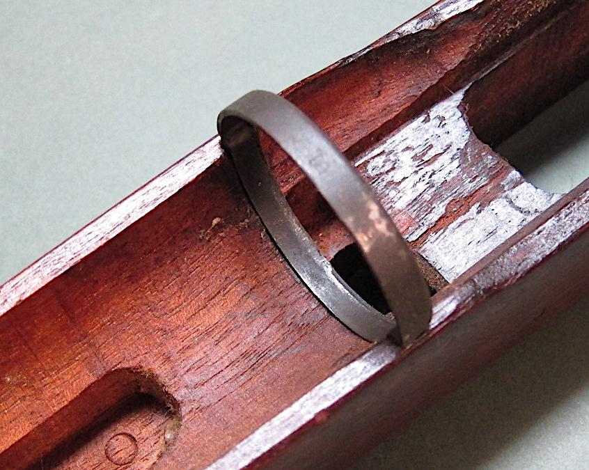

                The 1903 and 03A3 stock differ in that the 03A3 stock is cut just ahead of the receiver for the hand guard retaining ring. After production of the 03-A3 started the stocks were all cut for the retaining ring. Slightly out of focus, but the top of the ring has an R for Remington manufacture. Remington marked virtually all of it's parts while Smith-Corona did not.
