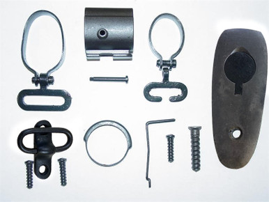

                  I just grabbed this stock, anyone care to comment? I can post better pics when it arrives.

                  • Darreld Walton
                    • 632
                    Looks like it ought to do the trick! Doesn't appear from the photos to have been sanded to death, or at all, for that matter (which is a good thing).
                    Would you mind sharing where it came from and a ballpark figure of what you gave for the set?
                    • dnmccoy
                      • 75
                      Just over $200 shipped to my door found it at Northridge

                      • dnmccoy
                        • 75
                        Are these kits from Sarco USGI?

                        • TomWatts
                          • Nov 2010
                          • 17
                          The ones I have bought have been, but others might not agree.
                          I know that sometimes SARCO has been loose with not putting REPRO on parts advertising for items that are REPROD.
                          Sometimes I use the web site for single orders. (When the item/history makes me feel pretty confident!)
                          Other times I call and ask the order taker to confirm the condition etc. and I get the order persons ID, so I can send it back with background information if need be.
                          So far I have been 99% happy with my SARCO purchases.
