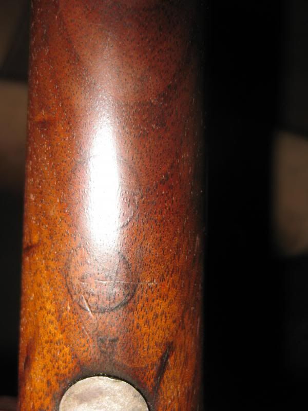

              Thee was a cartouche/remains of a cartouche on the left side of the wrist, hard to make out. Now I'm eager to get my hands on it. gotta pay some bills then I can finish making payments on it.

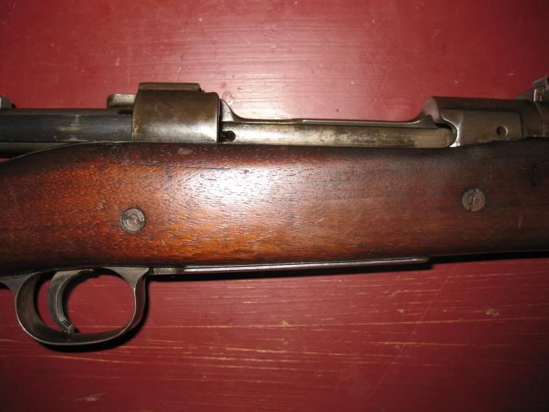

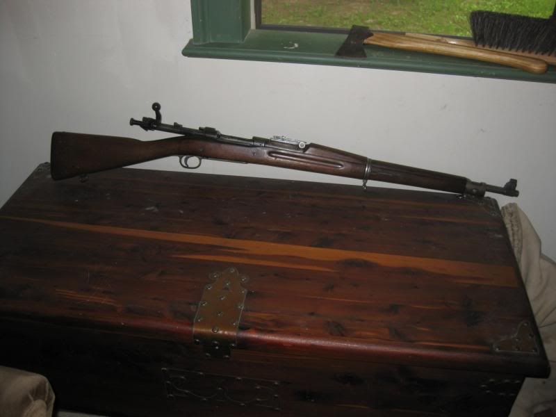

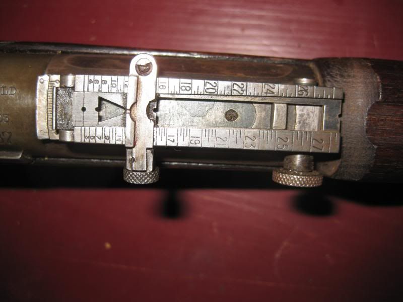

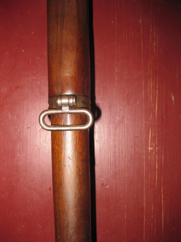

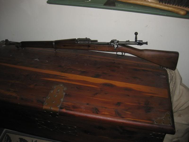

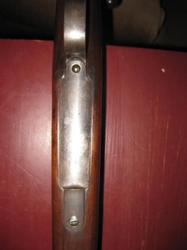

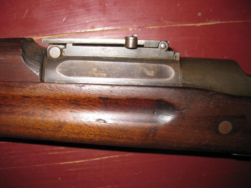

                Assessment and critique welcomed. I watched this rifle for 3 years and no one bought it. I liked it from day one. Finally I was able to buy it. With taxes it came to 700.00. Actual purchase price was 675.00. Probably high, I know, especially for a low serial numbered 03, but I'm ok with that. Seller was not coming down and allowed me to make payments over a long time.

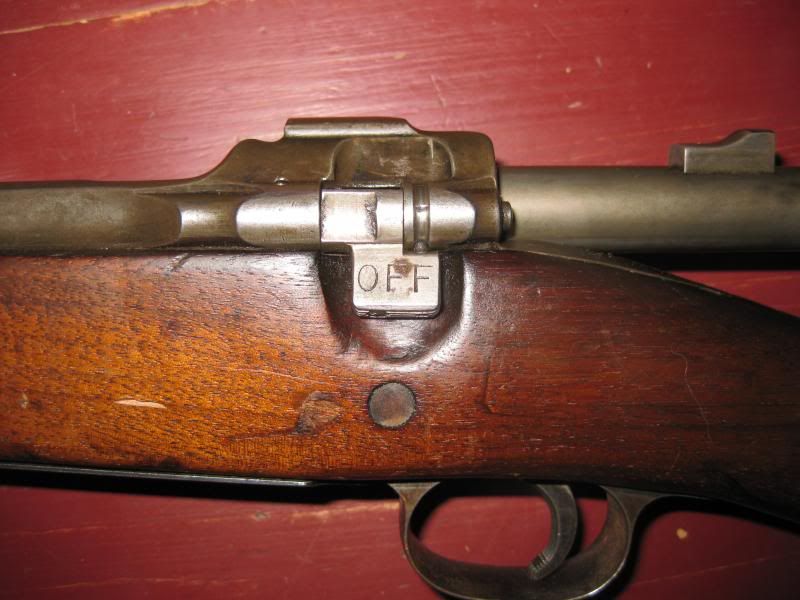

                  more of same

                      Low numbered, but I'd shoot it, just like you're planning to do. I'd start with new brass and keep track of the number of loadings. Once fire formed to the chamber I'd only neck size the cases.

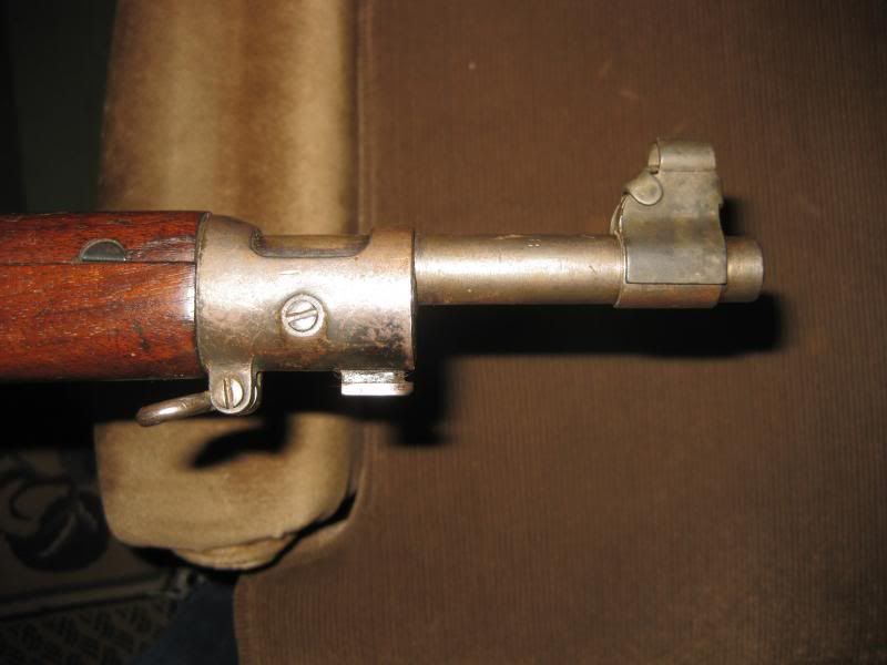

                          The stock looks like a possible pre-1913 RIA - looks like a "ghost" of a CN stamp on the left side. Does it have a large S on the foretip of the stock.

                            • Rick the Librarian
                              Super Moderator
                              • 6700
                              Yep, the stock dates to 1913 or earlier and was originally mounted on a RIA M1903.
