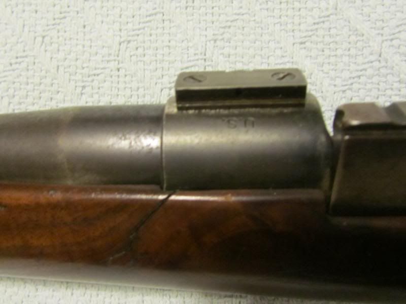

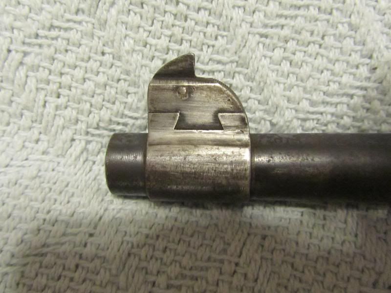

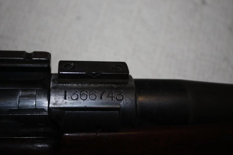

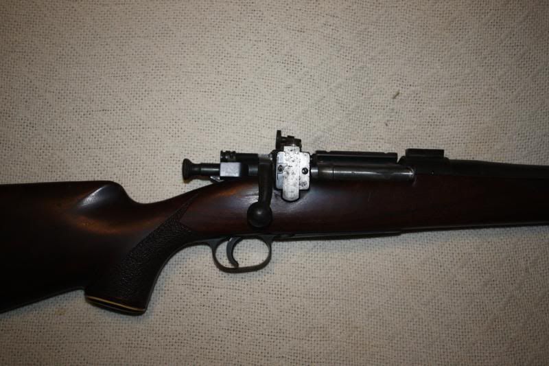

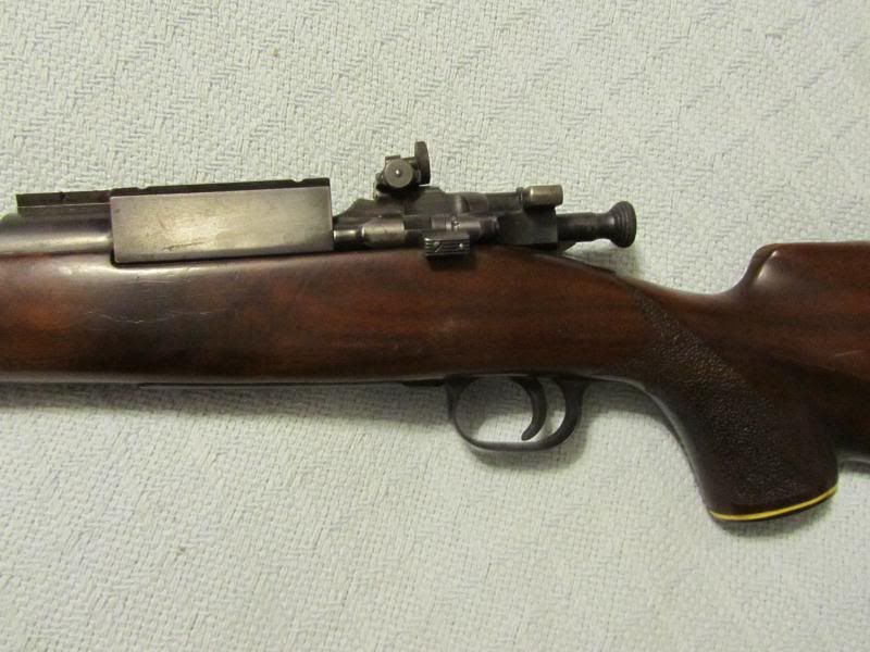

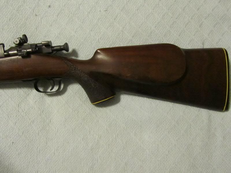

    i am assisting MP Marine by posting some pics of an 03 Sporter. I have looked but cant locate the original post!!
    Please look them over and feel free to post your comments.

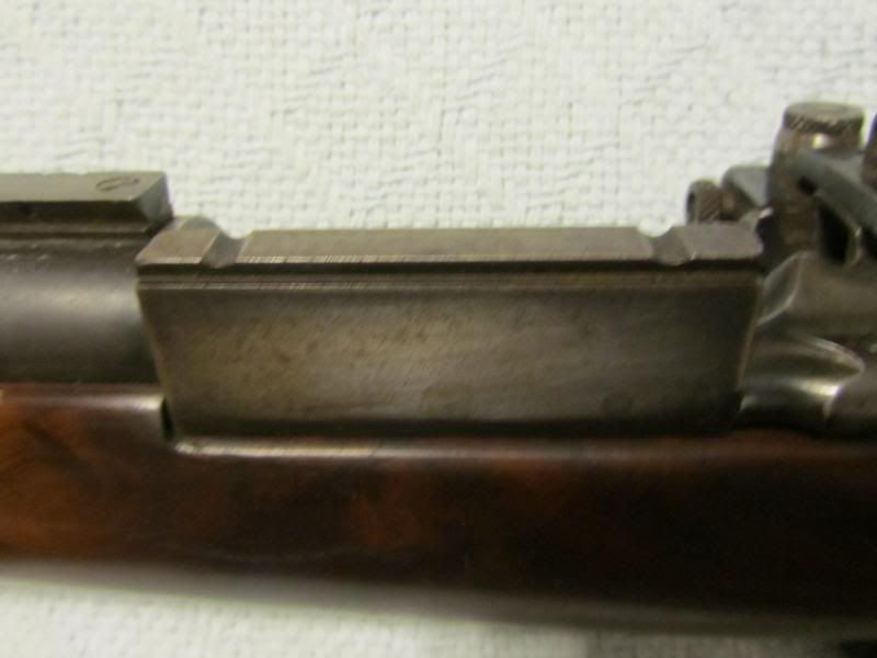

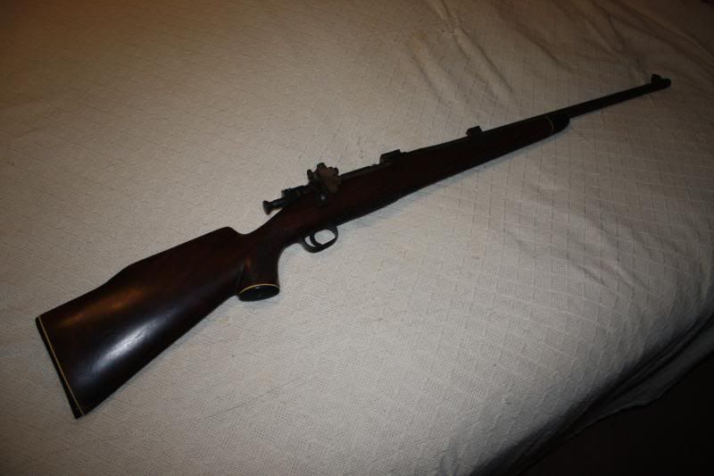

    It is the post titled "My $150 Score". Looks like someone added a side mount for a scope and put the rifle in a commercial "Monte Carlo Sporting" stock. I doubt the scope mount is a G&H. It looks to have two Weaver cross slots where the rings attach.

      mount is a Jeager mount,,,little oil will help out that ol girl. nice score.

        It's had a pretty good "make-over", but for $150, you made out like a bandit!!!

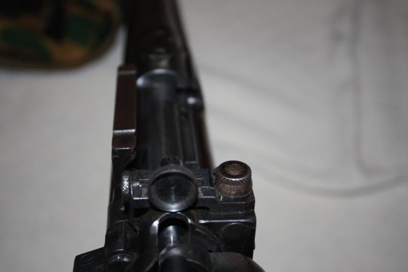

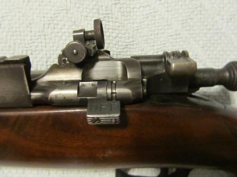

                      This rifle is on the SRS list as being sold as an NRA Sporter. It has the same Lyman 48 as came on the NRA Sporters. The side mount for a scope looks like a Griffin and Howe for the double leaver ring assembly. The side mount base will have the name of the maker. I see nothing that indicates to me the rifle is anything other than a standard configuration 1903 NRA Sporter to which the side mount has been added, scope block holes drilled and tapped and the gun installed in an aftermarket stock. The holes for the scope blocks could have been done by SA but I doubt it due to the location of the rear scope block. As best I can tell from the dark photos, the gun certainly should not be reblued or parkerized.

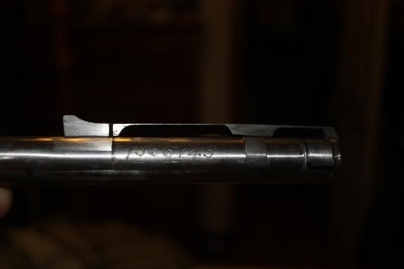

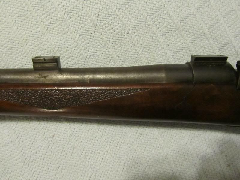

                          Could you post a picture of your barrel showing the contour?

                            Johnny P...I will send Jim a couple pics of the barrel contour and perhaps a few better pics of the side mmount ...which I agree with Herschel...is a Griffin and Howe...from all the pictures were I've been seen of them. I will be a few days as I am in Virginia for our son's change of watch ceremony. Will try to post Monday evening. Thanks to all for the insight. Semper-fi & This We'll Defend. Mike

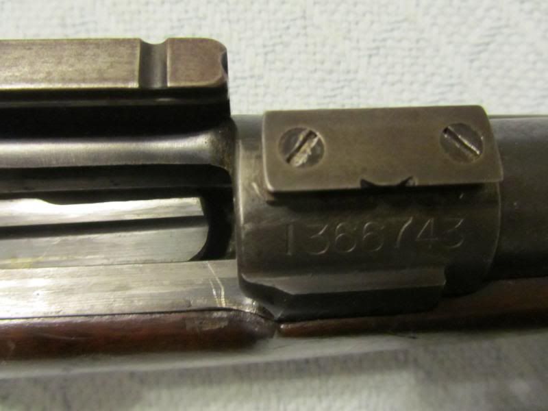

                              More Pics from marine-mp. The are big attachments so i will use p-bucket again. The double lever lever side mount was installed (two pins & three screws) then the side of the mount was milled and polished flat. I believe this was the way G&H installed their commercial jobs. Not that it's conclusive but I hope Michael Petrov weighs in. The checkering (stippled) and white line inserts do not look like G&H work or an NRA sporter. Interesting rifle though.
