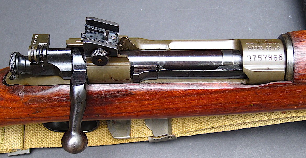

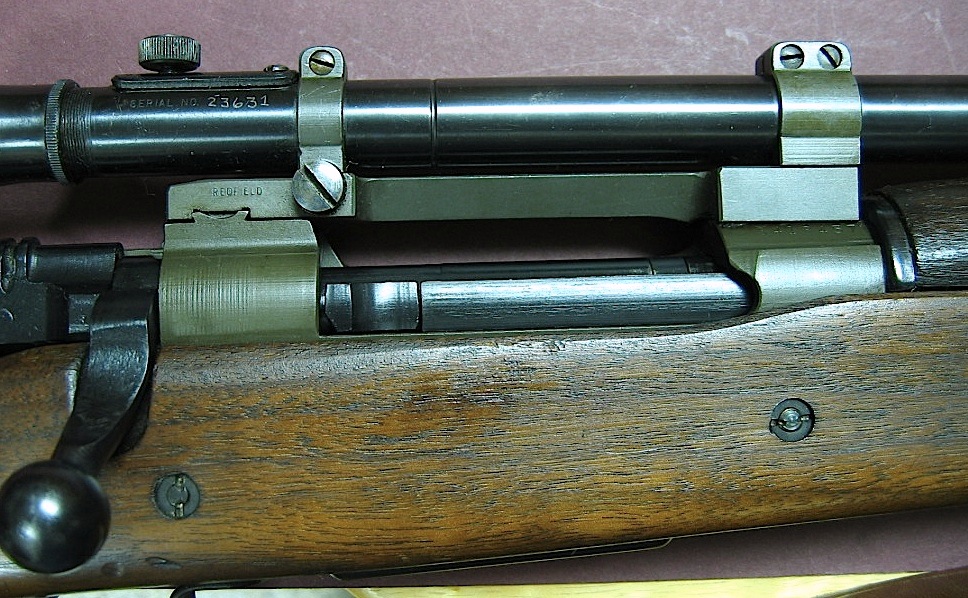

          Finish or shape? The original finish was blue. As to shape, the bolts were altered to clear the scope. The bolt handle was turned down and dished to clear the scope. The stock was altered to clear the turned down bolt handle.
          03-A3 top, 03-A4 bottom

            The finish is what was throwing me off initially. In doing my research I found that A4 bolts were always blued. There is always the scenario where someone could have refinished an original A4 bolt. The different finish got me thinking that there is always the possibility that someone could have tried to have an A3 bolt milled to match the profile of an A4. I would think that even with the best machining done there would be tells on whether or not it was an original A4 bolt. Those tells would be beyond my ability so I figured I would ask the pros.
              Originally the only parts Parkerized/phosphate finished were the barrel, receiver, and safety. During rebuild everything was Parkerized.
              You can't just mill down an A3 bolt to make an A4 bolt. The profile has been changed, requiring the cutout in the A4 stock for the bolt handle to turn down.
