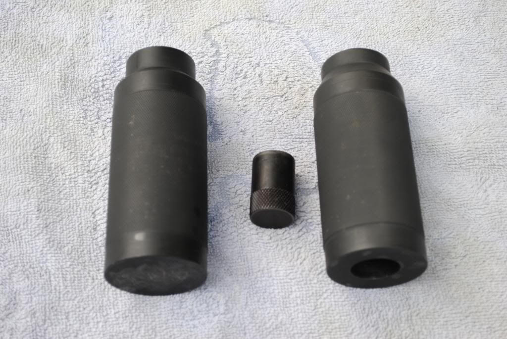

    Picked these up off of fleabay and thought some of you M1903 hobbyist's might be interested.
    I'm no Chuck, but I ain't no Bubba either, when I can help it, that is, and figured these might come in handy for some of you who like to have the right tools.

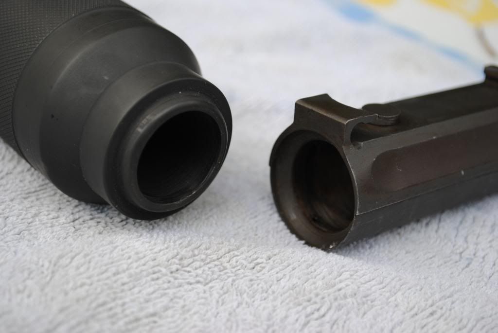

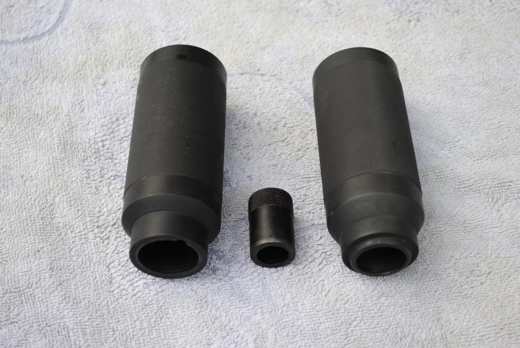

    These tools are well made. Fine checkering on the RSFB tools and a little course checkering on the little front sight install tool. Parkerized finish on all.
    Removal tool (barrel must be removed from receiver) is a stout 3.4 lbs. Compare that to an '03 barrel with complete front and rear sights installed, it weighs the same!
    Install (front sight must be removed) weighs 2.15 lbs and the front sight install 2.8 oz.
    I believe the seller has another set for sale now. If you would like to contact the maker of these, send me a PM, and I will forward his email address. I did ask for his approval.
    He also sent a set of directions with the tools, but they are kinda self explanatory. For the price, I find them to be a bargain. What else is there to compare them to?

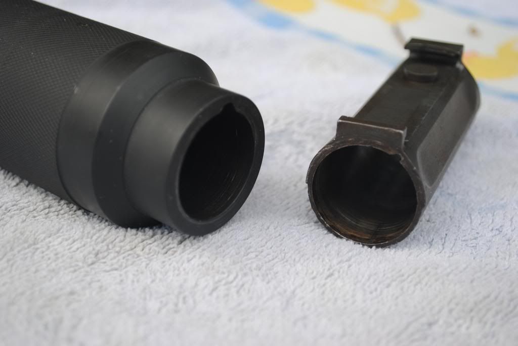

    I've used both rear sight tools with success. The front, I'm sure would work just fine. I popped the sides of the install tool with a hammer and also "dropped" it into the front of the RSFB to press bases on. Since it does surround the barrel, it could slightly mar the finish. The round bevel of the install tool is a very nice fit to the front of the base.
    Whatcha think? Feel free to comment/ask questions.

    I got the same tools and also find them very well made, and match up well to the surfaces they will contact in use. Hope to get time to finish assembling a pile of parts in the next month and I promise to furnish a better report then, myself. And compared to messing up an expensive original rear sight collar, or dinging up and uglifying a Springfield front sight base, they seem to be well worth their fairly modest price. Original parts are valuable, and even if they make repros, it's not the real thing. So we take good care of the original stuff! CC
