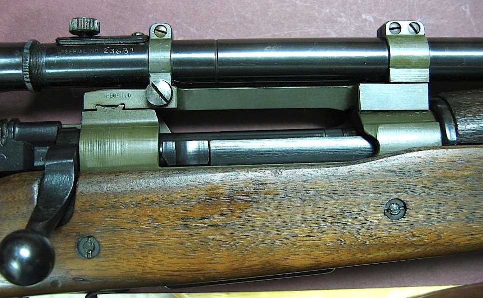

    My original 03-A4 serial number 3.413 million with barrel date of 6-43 has non-serifed safety.
    • kicker
      • Dec 2018
      • 102
      thanks nice looking rifle.
        According to the seller, he was a retiring Navy dentist, and bought it out of Benecia Arsenal. Don't know how long he had it, but I have had it 30 years of so. According to him it was complete as bought, where the NRA/DCM 03/A4 rifles did not have a scope.
