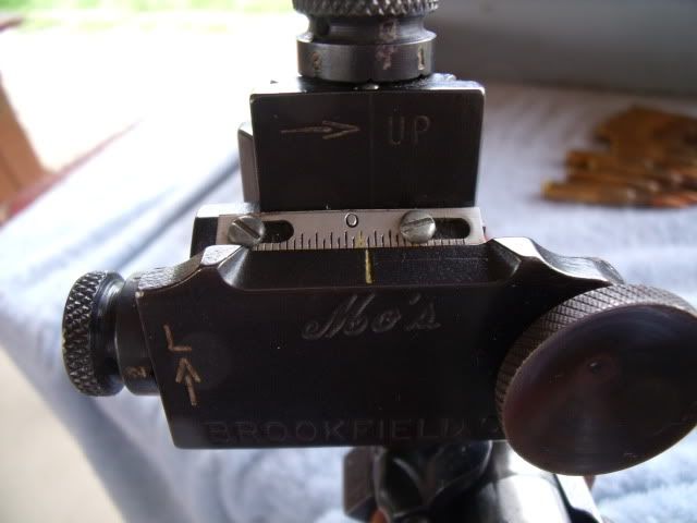

    I don't see one of Mo Defina's sights.
    Here's one.

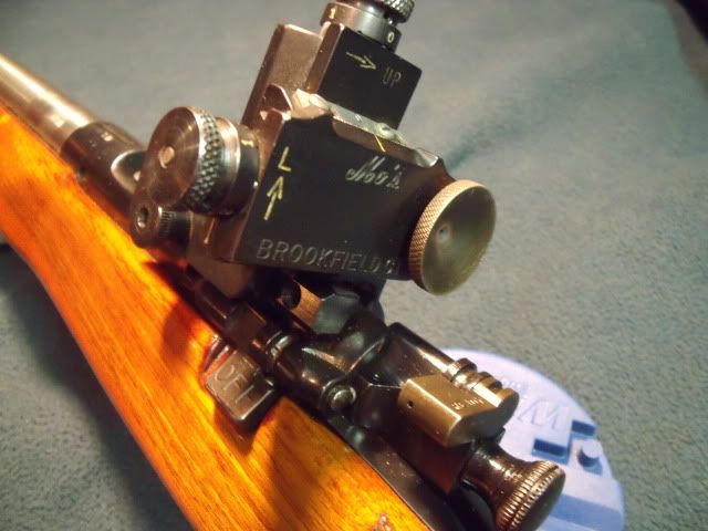

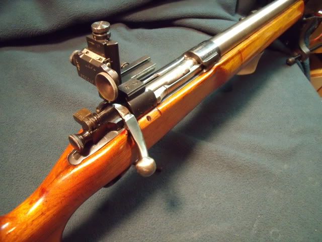

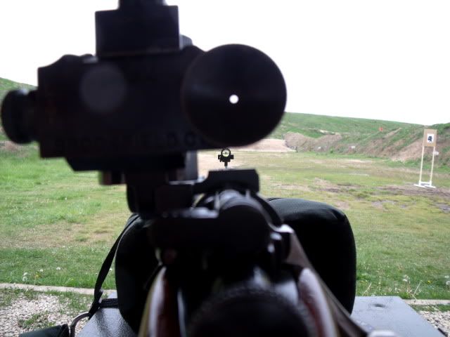

            I am not an expert on this sight. It’s on an "Across the course" club loaner I checked out for the summer last year. I posted lots of pics in this thread.
            http://www.jouster.com/forums/showth...3-Target-rifle
            Bob S. and Jim F. seemed to be quite familiar with Mo DeFina and his sights. Bob called the base as a Redfield design from 60-61.
            Maybe they will come along and fill in the gaps about Mo. Apparently he made versions of this for M1 and M14 as well. I would love to see those.

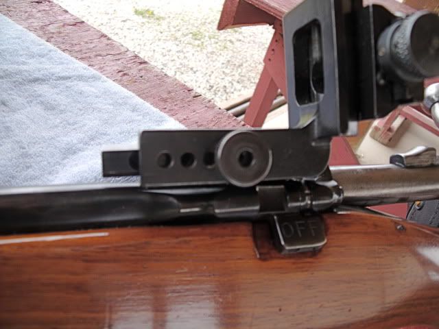

            Here's more of the mount.
            Now the sight. It is a monster. It's graduated in 1/4 min clicks

              Mo is still around, somewhere in Connecticutt, used to be in Brookfield (?), but I think he's moved. He doesn not have a web presence that I am aware of.
              The sight is a monster. I have never owned one, but IIRC, Bert Rollins had one on one of his Model 70's; and I think that rifle and sight are currently owned by Dan Grey.

                  The following picture is a Van Wie.
                  • Marine A5 Sniper Rifle
                    • 7450
                    Wow. You never fail to amaze me, Gary.
