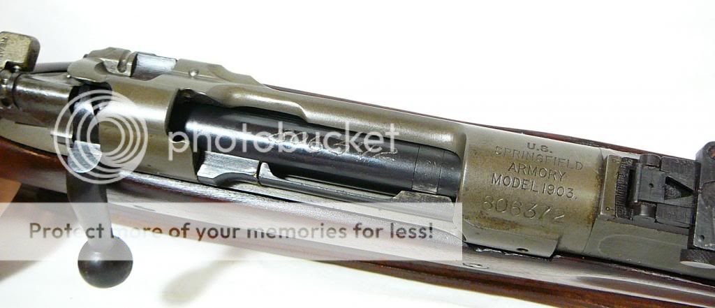

                This is the serial number markings on the bolt. I believe this what the USMC markings should look like.

                  I have a Greek return Remington 1903 I bought from the CMP. It's bolt is deeply engraved on the ball.
