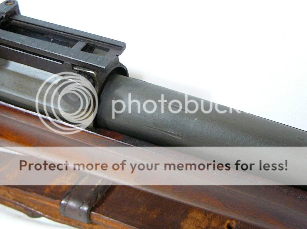

                    barrel vise marks

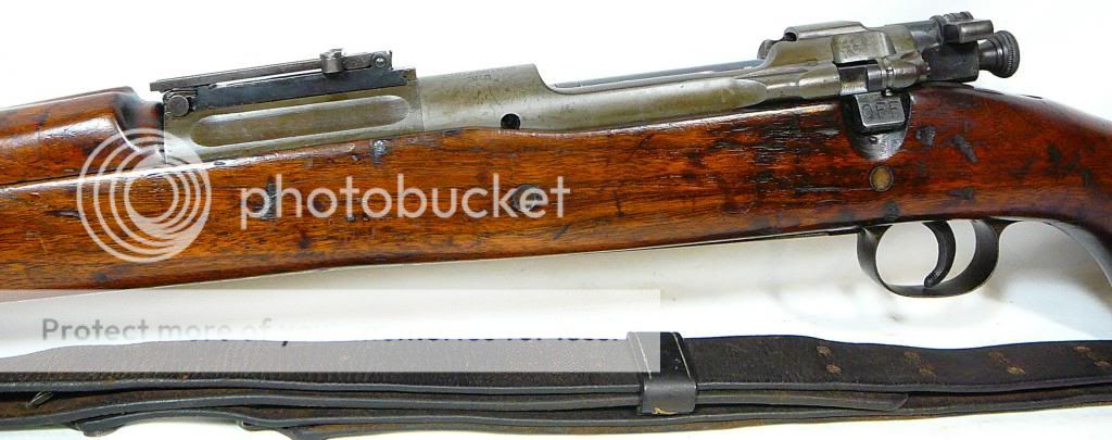

                    Here are some photos of a SA Jan 1931 dated barrel that was purchased from the Great Lakes Naval Retail Store in the 1960's by a friend (they also sold '41 & '42 dated USMC barrels too)these barrels sold for $3 each. (they also sold 1903A3 barreled actions for $10 )
                    Note that this barrel has the same type of vise marks that the USMC Sedgely barrels have in front of the rear sight base
