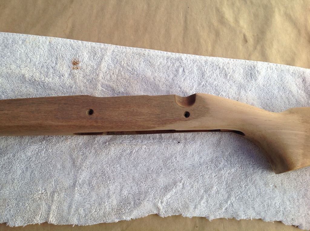

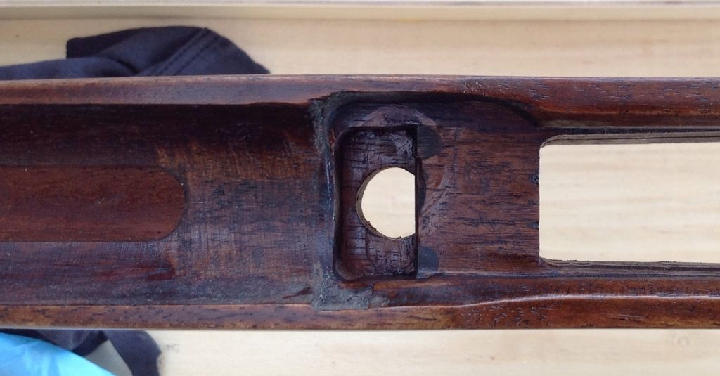

    I finally finished the stock (birch reproduction). A big thanks to all who made suggestions. The feeding issue was resolved at least when I cycle some dummy rounds made by a friend. It make it's way out to the range soon. Here are some pics of the last steps in finishing, including filing gaps behind the recoil lug filled with some dowels glued in place.

    Here is the finished stock.
    You'll notice I accidentally removed too much wood at waist behind the trigger guard. I got too carried away with the rotary rasp on my die grinder.
    I found out yesterday that the butt plate was never fitted, that will be another day.

      nicely done, happy to see that you found some good hard wood dowels instead of the Chinese junk

                    Excellent work and very informative. Was the stock bushing hole drilled correctly on your C stock? When I fit my Boyds S stock, I had to re-drill and Acraglas the bushing in at the proper angle.

                      No the hole was too big. I wrapped it in a little duct tape.

                        Was it too large even with the brass bushing around the steel bushing?

                          Rotary rasps are your enemy, there are plenty of hand file that work great on walnut and they don't take much longer. Harbor Freight Tools sell them and they are quite inexpensive. Same ones the woodworking stores sell but without the fancy packaging.
                          "the hole was too big. I wrapped it in a little duct tape."
                          Have a machinist make a new bushing from Rod stock, instead of trying to get the wood to fit.
