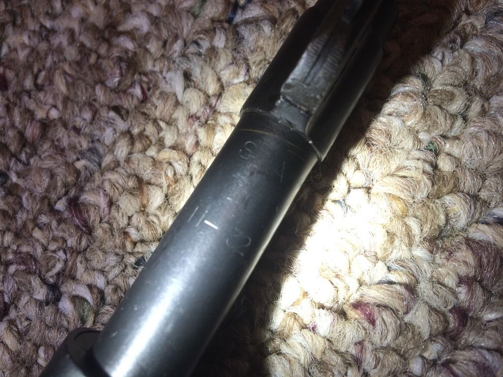

    The SN is in the 1.43 million range and the barrel is stamped SA 10-32. (original?)

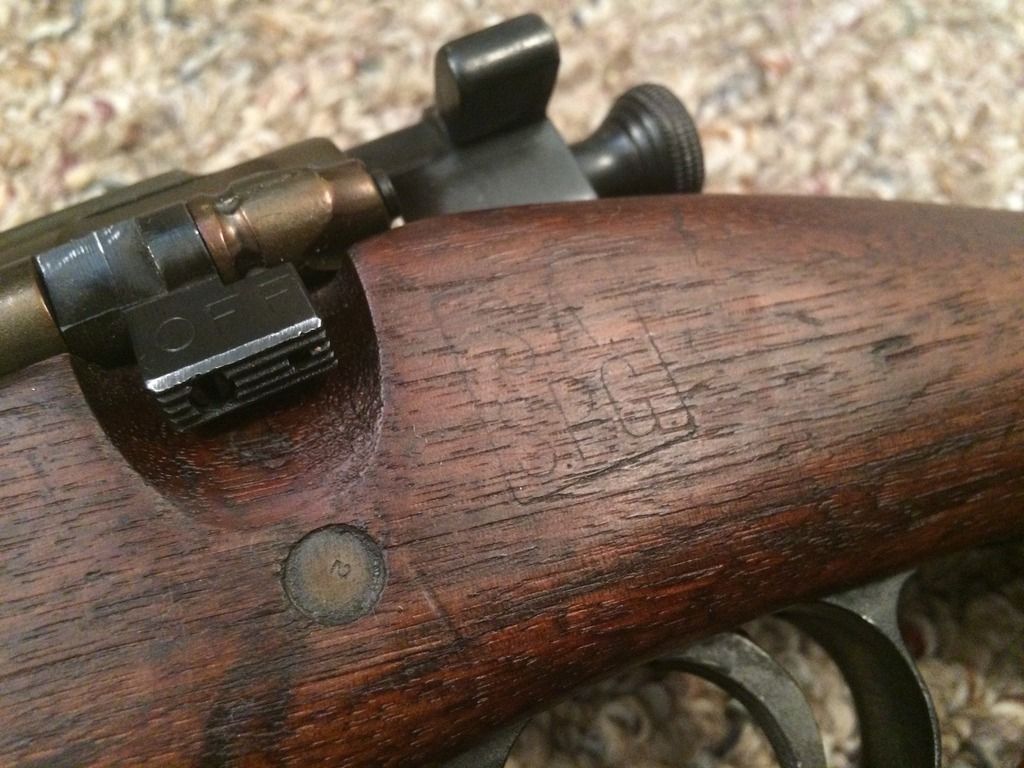

    The stock sports a SA/SPG stamp, P stamp on the grip, drawing number D1836, and a couple of letters here and there:
    I'm not sure what the other stamps are as they don't look like any rebuild markings that I recognize. The stock is stamped with a rack number so I am fairly certain it is a Greek return.
    The barrel is stamped with the manufacturer and date, but there's no Ordnance "flaming bomb" or punch mark- what is the meaning of this discrepancy?

    The stock has the Greek stamps. The hand guard is a replacement. But still it is nice.

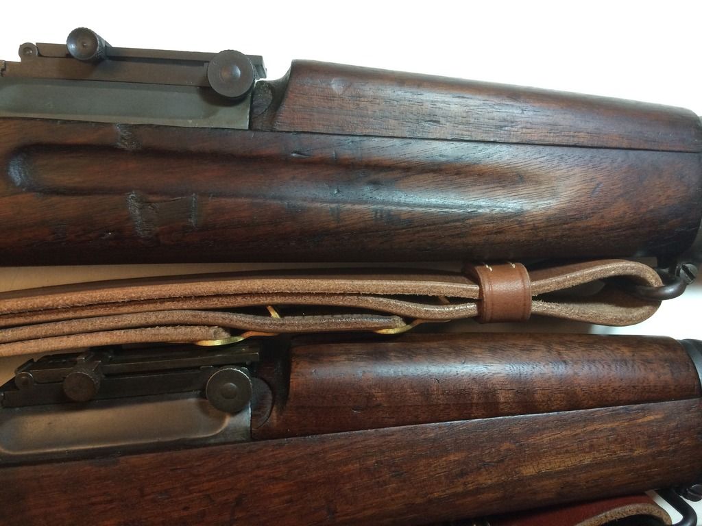

            Regarding the handguard, it appears to be the same version as the interwar SA handguard on my Marine rebuild 03. The drawing number on that piece is D28179
            It just appears to have been sanded down but the sight knob cutout is the same shape:

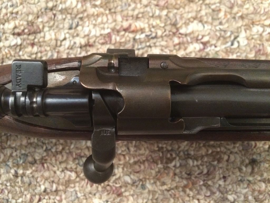

            John Beard, thanks for the assessment. What would point to it being a Bubba put-together? When I received it from Dupage Trading there was a fair amount of cosmoline hiding in the stock/under the receiver and there was also cosmoline in the bore. I also forgot to post this photo but the receiver and breech finishes do not match:

              The most troubling aspect of your rifle is the copper-colored finish on the receiver. I am not aware of any military finishes which look like that, except perhaps on a ceremonial rifle. And the front barrel stub looks like it has been polished and blued.

                D28179-marked handguards date from the late-1930s, several years after your rifle.

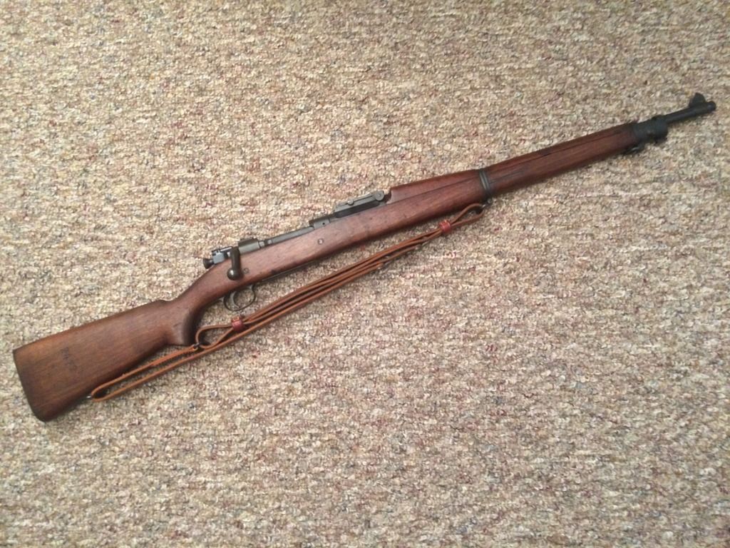

                        So she isn't a purebred but she sure can shoot:

                          Nice iron. Put to proper use, I see. And well done.
