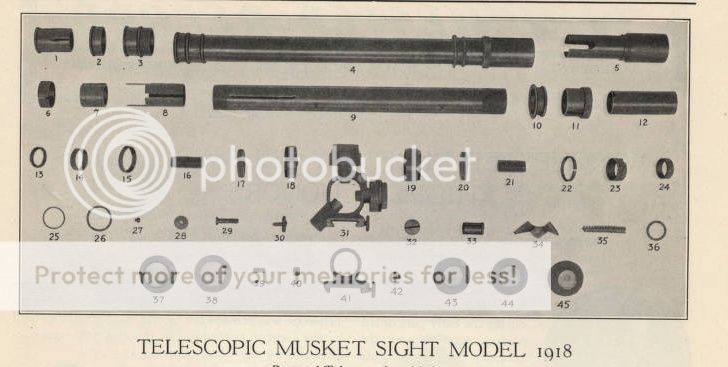

                Fred, I bet that slide was made for the Winchester Telescopic rifle Model of 1918. It was going to be the new Army Sniper rifle. I would have to go back and look but the Army ordered like 59,000 of them. But the war ended before many were made and the contract was cancelled.
                But I really bet that slide was made as a companion piece to go along with this rifle. That would also explain why so many were NIB back then.
