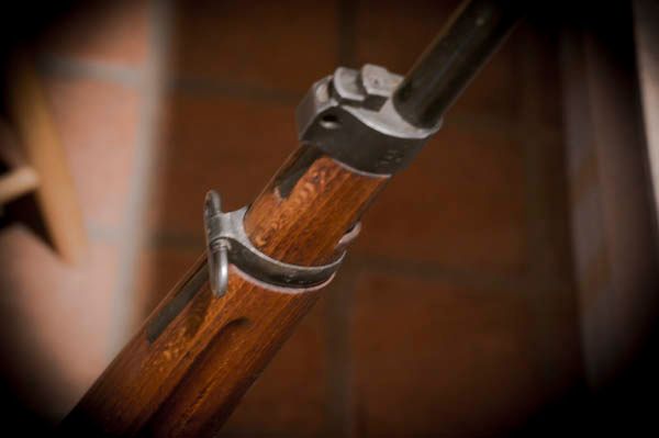

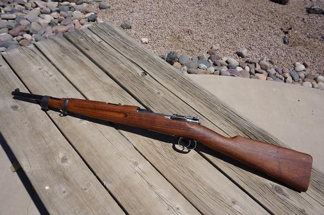

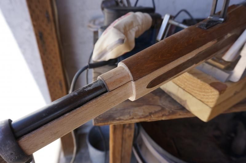

    Here's what I did: I got some instructions from someone who did the same thing. I had to find a 96 stock to cut down.
    I went up to J & G sales in Prescott and found a long stock that matched the handguard and went from there. I had my very competent gunsmith take the horrible extention off the end of the barrel. Here is the pictorial result.
    It's a little Bubba'ed, I made some mistakes but I smoothed up most of them. When you start carving down for the band springs your into paper thin wood because of the cleaning rod hole. I took this out last weekend and it out shot three other rifles, a scoped, sporterized M 17 and one of my accurate garands.
    That made me happy. ser. 63287 man. 1915
