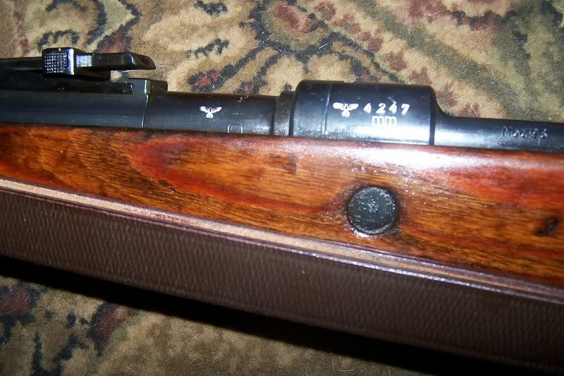

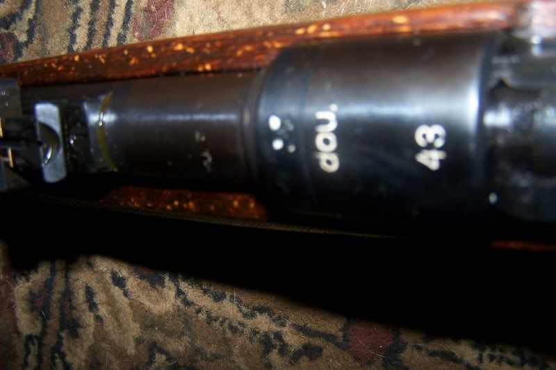

            Here is some pics of the proofs. That bottom pic, bottom rifle with the bolt open is also a 98K custom job in 25-06.

              The rifle shown by Afghanvet is a K.98k, made in 1943 by Waffenwerke Brünn, Bystrica, in German-occupied Czechoslovakia. The left side says "Mod. 98".
              KenK, are there any marks on the left rail of your rifle?
              8x57 or 8x57JS is the European civilian designation of what we call the 8mm Mauser. The German military called it simply the 7.9. (Yes, folks, I know about the 8x57J, but that K.98k doesn't use it and Ken's .358 Winchester caliber Mauser doesn't either, so I chose not to complicate things.)
