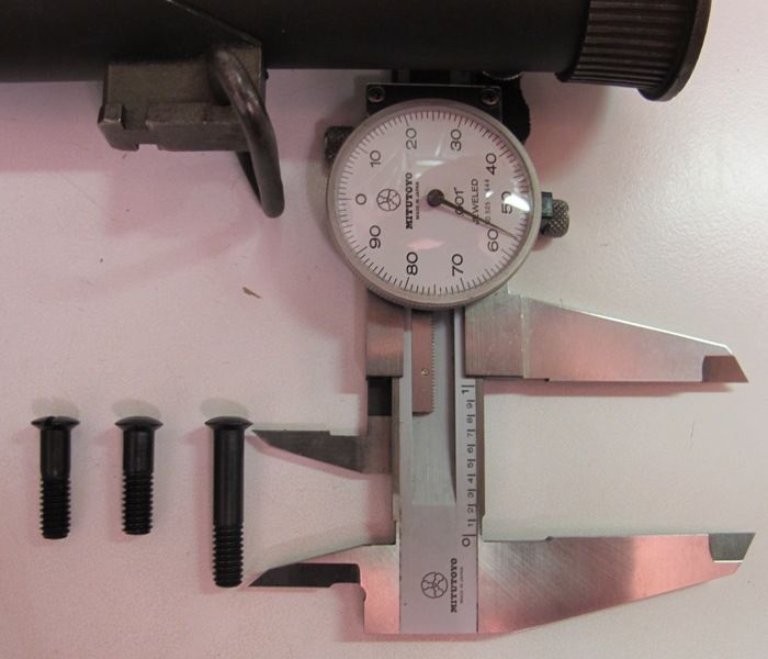

          First photo:
          Top: Remington manufactured Clamping Sleeve is the early, welded, One-Piece design. Screw length, measured from where the shaft meets the screw head, is 0.693".
          Middle: Remington manufactured Clamping Sleeve is USMC Mk.1 Two-Piece design. Screw length: 1.057". This same screw is also used on the Two-Piece design with Bead Sight only.
          Bottom: Remington Bracket/Clamp is basically the offspring of the Mk.1 Clamping Sleeves - introduced in the early 1970's and still produced today as part of the Remington M870 Magazine Extension Kit. Screw Length: 0.735".
          2nd Photo:
          Shows a close-up comparison of the three difference screw lengths: Left screw (0.735") - for current Remington Magazine Extension Kit Bracket; Middle screw (0.693") - for One-Piece Clamping Sleeve; and Right screw (1.057") - for Two-Piece Clamping Sleeve.
          The current Magazine Extension Bracket (0.735") screws will work on the One-Piece Clamping Sleeve, no problem - just a touch short. These screws are readily available from Remington at around $4.50 each. However, they are too short for use on the Two-Piece Clamping Sleeve.
