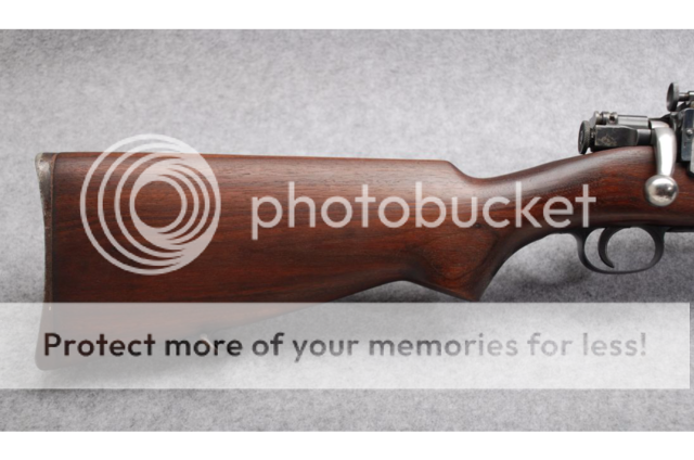

    Hello,
    I purchased this rifle and although I have researched some over the last few years it would interest me how much of this rifle is original.

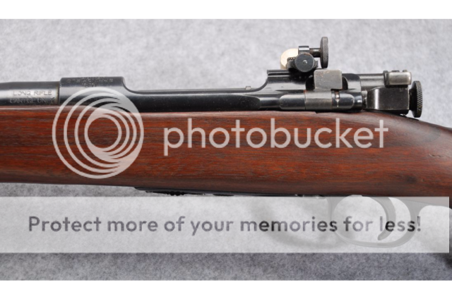

    The things that I know about it are the barrel is marked 10/26 and the receiver is marked M1922MI. I think it is a NRA sales rifles as the barrel is D&T rearward of the stock band. That's about it,so if there are any experts out there, I would be highly appreciative of your thoughts on my new rifle....good or bad.
    p.s. The rifle weighs 9#'s,LOP is 13.5 " and barrel length is 24"

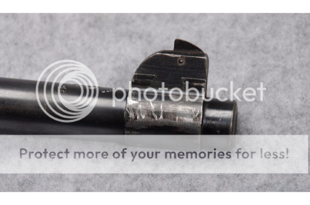

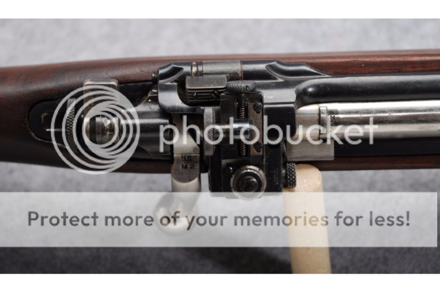

    One thing that interested me was this looks to have been upgraded to the M2 standards, but the receiver was not marked as such. Also the receiver looks blacked and the barrel rust blued? The rear sight is a Lyman 48C? But I don't know if the front sight is correct.
    Does the #9023 show up in the DCM sales records? In what configuration?

    I believe you have a bit of a "mongrel" there . . . .
    Being that the receiver is blued, marked M1, and drilled and tapped for the rear scope base, it might be a "sales" rifle (as is the stock) . . . but . . .
    My M1 sales rifle looks just like yours . . . . except for the barrel.
    My M1 sales rifle does NOT have the caliber inscription on the breech-end of the barrel . . . I think only the "issue" type had this inscription.
    When Herschel Garner weighs in on you rifle, he will straighten us BOTH out on your rifle.
    I also have the M2 bolt and magazine (as well as the original, matching serial, M1 bolt/magazine), so I can switch from the M1 to M2 configuration at will.
    Never-the-less, you have a dandy rifle there . . . it should serve you well! --Jim

      You are talking about the "long rifle markings on the barrel? Does your rifle have the M1922MI marking too,with the same style bolt and markings? Also I think this receiver looks to be "blacked",but since it is still in shipment,it could be blued.- Roger
      • JimF
        • 1179
        Yes, Roger, I am talking about the "long rifle cart'ge only" marking. (My rifle lacks this marking on the barrel.)
        My rifle has the very same M1922M1 receiver marking also.
        I believe your rifle originally had a M1 bolt and magazine (as has mine) that was serialed to the receiver.
        The "black" color of your receiver is likewise the same as mine . . . that's why I believe your receiver (and possibly the barrel also) is ORIGINAL finish from the armory.
        Is the bolt "trough" or "raceway" of the receiver "bright"? (I'm thinking it is.) If so, I believe it is NOT refinished.
        Is the bolt serialed to the receiver?
        I'm of the opinion that your rifle is an armory-produced, "sales" version that was converted to the M2 configuration using an "issue"-style barrel that was blued (rather than parkerized), and somehow escaped the M2 stamping on the receiver.
        It could, however, have had its' barrel replaced with a blued "issue" type OUTSIDE of the armory . . . hence the lack of M2 marking on the receiver ring.
        It also could be that the early "sales" rifles DID have the "long rifle" stamping on the breech end . . . I just don't know--I'm still learning!

            The finish on this rifle appears original. This is the later receiver markings, changed from the first style so that the drilling would not obscure the markings. The caliber markings were added on later 1922M1's, but off hand I cannot remember when this occurred. Yours is an NRA version of the 1922M1 that has simply had the bolt replaced with a late M2 bolt (note the ability to adjust the headspace?) This could have been done at Springfield, or later by a previous owner. There were a few 1922M1/M2 rifles produced, but these are not simply rifles with later bolts added as suggested in an article by Butch Eyberg. These M1/M2's were later, totally different rifles with later dated barrels with blued metal.

              The front sight you mentioned looks to have been filed down for a lower profile. Probably so the rear peep need not be positioned excessively high to have a better "cheek weld" with the stock comb.

                  If the front sight blade has been filed down you might want to replace it. It is the same sight blade used on the 1903 rifles. They are readily available and inexpensive..
                  There is not much I can say that has not already been said about rifle. If the headspace adjustment screw head has been covered with soft metal that would be pretty good circumstantial evidence that the bolt was installed by SA.

                      Herschel, would not that stock be to early for that receiver?
                      Charles
                      • Herschel
                        • 973
                        No. That is an NRA stock, which is also referred to as the 1922 stock. It came out on the original Model of 1922 rifles. It was also used on the 1922M1 Sales Variation Rifles, the 1922M1 DCM Club Issue rifles and the M2 Sales Variation.

                          Roger, The 1922M1 on gunauction that you provided the link for is one that was equipped with the early type M2 bolt. I noticed that the receiver marking was not changed from 1922M1 to 1922MII. This was one of the type that Butch Eyberg referred to in his 1985 Man At Arms magazine article as "Transition Models". These were late production 1922M1's that were fitted with the M2 bolt and magazine before leaving SA as new items.
                          Your rifle has the late type M2 bolt and is a earlier production 1922M1 so it would not fit into the transition rifle category.
