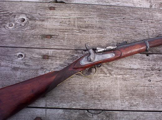

    Nepal "Sergeants Rifle". Looks good, shot great, then got disappointing.

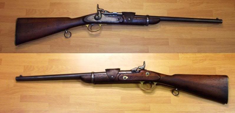

    British-made carbine. Night vs day in regard to quality:
