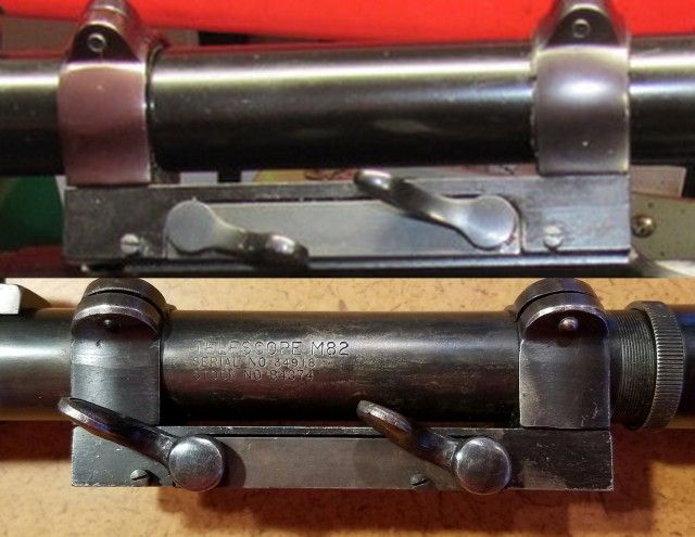

        Nf1e, is that a original mount? It looks taller than mine, height wise. Even like the one stop screw for the thumb lever is in a different location.
        Like on mine, with a rubber eyepiece it won't clear the receiver. If I remember right, I had to take the eyepiece off to even get it to slide on.

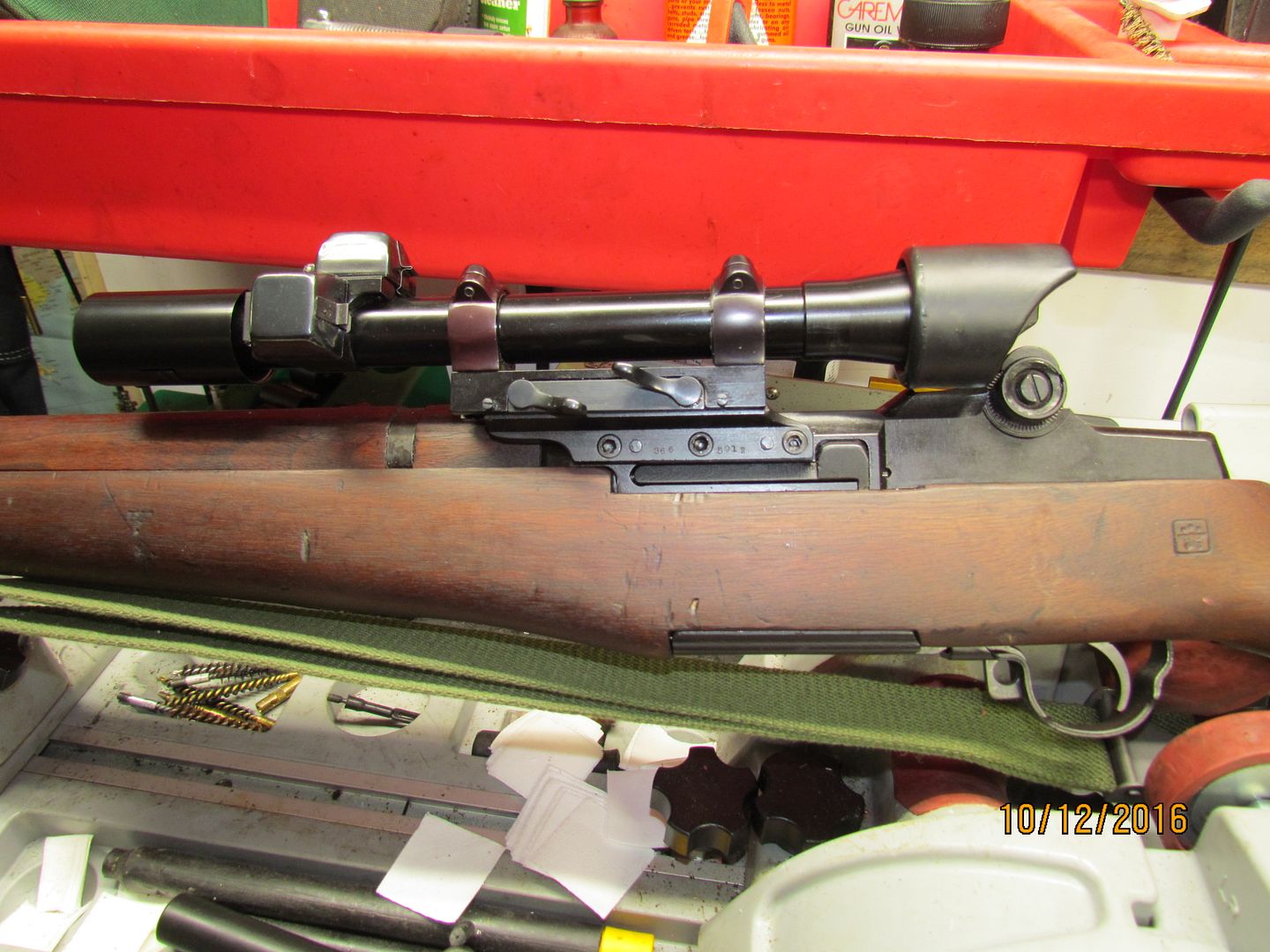

          Its been a few years since I tried a m84 on a M1C. But if I remember right, the eyepiece hits the receiver and it won't slide on. But if you take the eyepiece off, it clears the receiver.
          Like this is one of mine. It's a m82 and I can't even fit a penny in between the eyepiece and the receiver. There is that little clearance. My mount is just a USGI WWII numbered one. But a M84, the eyepiece diameter is bigger than a m82. So if I remember right, it was hitting the receiver that I circled in yellow. That was the issue.
            • 2151
            Clearance on my M1-C With M-84 looks identical to your photo.

              I think your mount is taller though. Like the height it's raising the scope up, I mean. Putting it side by side with my mount, your mount and rings look like they are raising the scope up and giving it more clearance from the receiver.
              I think the OP is trying it with the mount that came with the C, like mine on the bottom, and it just doesn't give it enough clearance.

                Sorry for butting in. I did get a current production mount from Griffin and Howe. I assumed it was the same as the old mil spec. Guess 50+ years of making the things has caused a couple of improvements in usability.

                  Oh no you weren't butting in at all. Actually I learned someting off you. I never thought of the fact that there are different height mounts out there. Actually that is sort of interesting if you think about it.

                    The mount on mine has rings for 1" scope and inserts for the 7/8 M84.

                      I talked to Dave McClean about this issue and he stated that even though you see pictures of the M1C with M84 in TMs and FMs, it was never really a good fit. In fact, according to Dave, it just doesn't fit with the eye piece. cplnorton your mount is identical to mine.
