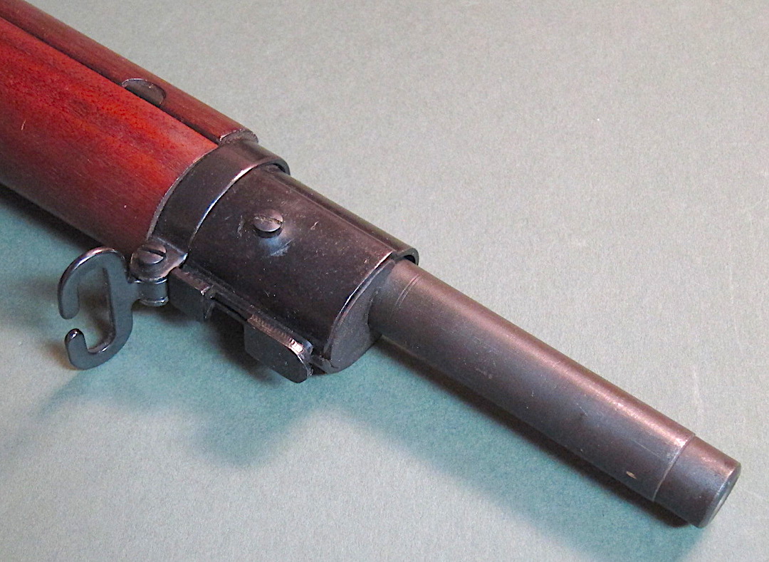

            This is the stacking swivel as used on the 03-A4. With the change from machined to stamped small parts the stacking swivel/upper band became two assemblies.
            • Tom in N.J.
              • 307
              By the way, M1903A3 / A4 sling and stacking swivels are permanently assembled to their bands by staking, and are not to be taken apart.
                Some are determined to remove the screw from the stacking swivel assembly, and normally end up with no threads left in the band.
