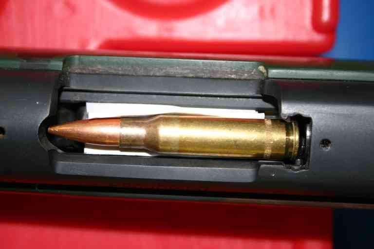

                  ill post a picture of a 40XB that i own, with a notch cut to clear the .300 mag.
                  That notch on your 40X is not to clear a 300Magnum cartridge. It's to allow stripper clip feeding of a 308 or 7.62 length cartridge.
                  I'll see if I can find some pics to illustrate that;

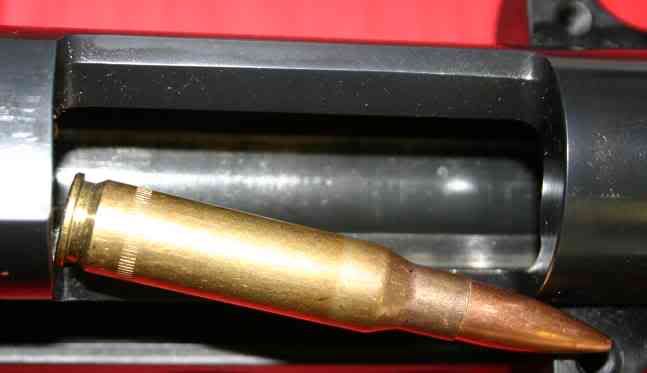

                    Here's a pic to show what the clearances are like for a Rem Short Action ie 40X.
                    Here's what a 7.62 looks like in comparison to a standard 40X receiver without the clip slot or front relief cut;
                    It's worth mentioning that all 40X's are going to be short action...even the magnum calibers. The pic above is a 40X solid bottom, single shot in 7mmRemMag. I don't have to remove the bolt to feed cartridges.
